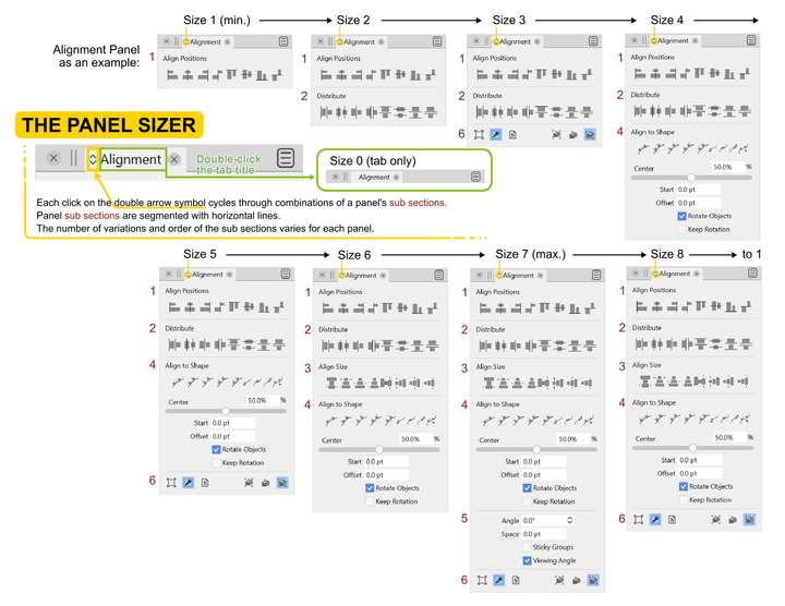

  • One of the many things VectorStyler excels at is customization. Once becoming familiar with the software, inevitably we find ourselves wanting to tailor the interface to make it our own.
    After playing around with Panel layouts for a bit, I was particularly intrigued to discover this tiny "up & down" double arrow icon next to the title tab of each panel. I started clicking on it, and it took my brain a moment to understand what was going on. After an embarrassingly drawn-out period of time, 🙄 I started to understand the logic, which evolved into an "Ah-ha" moment, and then the feature started to grow on me.
    As a result, I thought I'd share a simple reference guide with the community to bring attention to the feature and attempt to illustrate its functions.
    I welcome all feedback. I am no authority, this is just the result of self-discovery. If you have any extra insights or edits, please let me know how I can improve!
    Click on the image for a larger version.
  • @Victor-Vector said in Panel Sizing - The often overlooked customization:
    I actually use it a lot. I think the symbol is overlooked when several panels are lined up, but I immidiately tried it out the first time a made a panel floating. Then it begs for a click.
    My first guess was that the icon meant 'Minimize panel' (like the double click on the panel title) but I clickly learned and memorized it.
    My only issue with the method used to toggle between the different setups is that I never remember my favorite because there are no numbers or anything that can be used for reference. It is also not always immidiately obvious that it is the same panel - just another configuration.
    To avoid complexity that end in the majority of users using the defaults anyway I would recommend just three views per panel: minimum, medium and maximum - unless one of the panels obviously could need one or two more for certain scenarios: handtracing, drawing, flowcharts - you get the general idea.
    A tooltip would certainly help.
  • @Ingolf Thinking of your ideas to simplify...
    What if the icon was like a config function, so when you click once on the double arrow icon (or insert icon idea here), it opens the Panel in its maximum size, with all the subsections exposed. Beside (or on top of) each subsection is a visibility eye. The user clicks on each section to toggle it visible or invisible.
    Clicking back on the double arrow icon (or insert icon idea here) collapses the Panel showing only the selected visible choices.
    Advantages of this idea is maximum configurability for each Panel's subsections.
    Disadvantage is it might not be as efficient as moving through a cycle.
    It's fun to bounce these ideas off each other!

  • In itself, i find the Panel Resizer ok and a good idea.
    But it bothers me that it only works in one direction.
    Would he work in both directions forward and backward
    i would have more fun with it.
    At least it is nice that it keeps a once set state
    even after a program restart.

  • If the button would display two downward arrows when the panel can still be expanded and two upward arrows when it's at max size and clicking it will contract the panel, that would be enough for me:
    alt text
    Same with the horizontal panels, but with arrows pointing right if they can be expanded and left when at maximum size.
  • There simply isn't enough space for a more meaningful icon, and when I think about it the icon is quite meaningful; "make me bigger or make me smaller". That is always TRUE with the cycling forever algorithm at play.
    Spending precious time on the icon itself is to me a great example of the Law of triviality (Just breaking balls here, relax!)
    What could in fact be improved is how the panel can be customized easily (and with easily I mean both in interface and code)
    I think @Victor-Vector has a great idea. I would probably only need to customize one view and if I needed more for other use cases, they could be saved in different workspaces designed for these use cases.
    Still, low priority far down in the backlog. If I need a panel, I show all of it. If it is too big I minimize it (double click the title) when I do not use it. Workarounds ad libitum.
    @b77 The icon (and the feature) actually means "moving along a number of states" of the panel. In most cases of course these states result in smaller panel layouts, but this is not always necessary (and might change for some future panels).
    I would suggest using a modifier key to move backward among the panel states, keep the icon as it is (up/down, left/right), move forward with regular click, and backward with shift+click. Would this work?

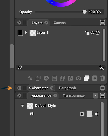

  • What I mean:
    LATER EDIT: Double-clicking the panel's tab does this already. 👍
