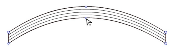

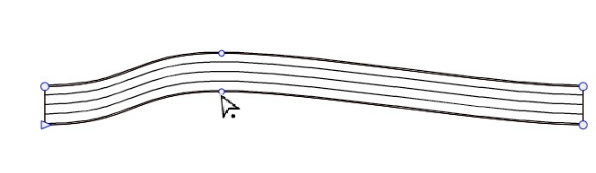

Don't know what Warp Effect you used Warp seems
to be a bit limited when editing nodes.Here a Way with the "Envelope Shape Effect".
Some Explanations to insert nodes
select a a node and press the + Key (works also with Envelope Shape Effect)
( Btw. most Node editing Tools work with Envelope Shape Effect )To change Values in a Panel set your Cursor in that Field
and press UP- or DOWN Arrow KeysHere the Video Example with Envelope Shape Effect:
Here the Way to get a better Curve Warp with Envelope Shape Effect.
First with Cubic Curve then Quadratic Curve.
See Video here:

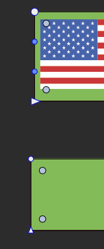

I'm trying that Envelope on a rectangle with that flag nested and it worked once. Now i can't replicate it and can't find the right option. The flag doesn't follow the envelope.
@plrang The Envelope shape has a bit larger nodes at the corners. This is either not the Envelope or some option is disable to avoid transforming the group content.
Select the object and check what is listed in the Shape Effects panel.
Then select the Envelope / Mesh in that list, and press the second button at the bottom of the panel to enable the editing.

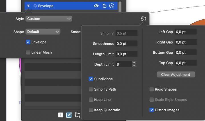

@Subpath said in Warp - middle point of an effect?:
Does Envelope work also with Bitmaps ?
Yes it should work: open the Envelope (or other) effect options and click on the settings icon in the top right corner.
This opens the distortion options popover. Enable the "Distort Images" option.

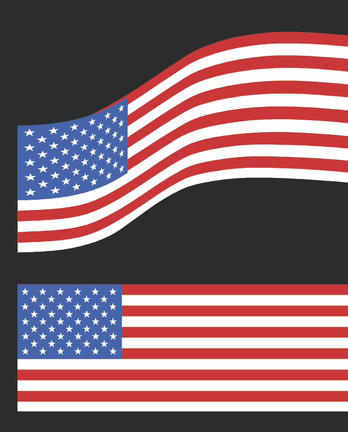

Here is a longer envelope with nested shapes - clip. That green rectangle is a container for using the envelope. As you can see all the transformations work except that one where I'm trying to use nodes added to the rectangle.
It worked once, but I can't replicate it since I was so sure about the solution I forgot it ;->Some additional thoughts:

I tried the envelope on a group of the flag elements and it worked as in your example.
But I need that clipping rectangle to make the flag shorter sometimes and with that rectangle I can't make it work :-}.
I just don't want to adjust the width each time I need to change something.

@VectorStyler I think your point about the nodes was also correct, because here is the difference between the working and not working rectangle (as an envelope).Seems like the second one got converted to a curve or something.

In the very last step (at 1.11), it looks like the envelope is not edited anymore, only the group clipping shape. In the shape effects panel, the second button should be active, not the third.

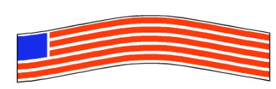

There is still one problem, here is a simple Envelope nicely working, yet those distortion are bit too much. Can that be fixed?
I can allow distortions to a certain level, but would like to know if there is anything I can do to improve it.
Not sure exactly which part is too distorted, are these the red stripes? Some distortion options like Smoothness and Subdivision (seen in the screenshot sent earlier in this thread) can be used to control huw much distortion occurs.
@plrang
... yet those distortion are bit too much ...
to set more Nodes (select one Node and press + Key)
or try a different curve Typ (Quadratic / Cubic)
could also be helpful
@VectorStyler Sorry, I was dead tired, 2022;)
Yes, stripes and that blue part of the flag got some offset from the stripes. Additional options didn't fix that. Well I can live with that and fix things by hand. That's my first use of this effect, so gonna test it more later with some production ready design.
