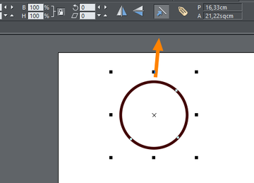

But as I wrote, once set it stays active even if you restart the program, until you turn it off again.
The Toogle is as I wrote in the Contex Bar and very easy to reach.
Here a Pic:
.I have no particular need for it, so I can live with a toggle

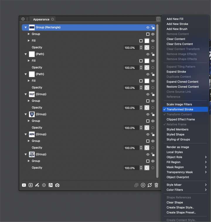

@b77 said in Can Scaling stokes and effects be on by default? Can we make it easier to switch all child sublayers by editing the setting at the parent level?:
A sticky button would be really handy for this as 90% of the time I need strokes to scale
@Dazmondo When creating new documents, enable the "Transformed Stroke" option in the Document Setup -> General view.
Doesn't work for me - the strokes only scale when grouped ????? or if scale image filters is ticked
@VectorStyler It looks like it doesn't work for parametric shapes (smart shapes). Easily fixable, I guess.
@Dazmondo Convert them to curves and this works as expected.
@Dazmondo Yes, a few parametric shapes are not "scaled" (rectangle, ellipse).
An other way to go around this is to disable the Direct Shape Transformation option in Preferences -> Editing Options 2 (bottom-right corner).
An other way to go around this is to disable the Direct Shape Transformation option in Preferences -> Editing Options 2 (bottom-right corner).Done and working ----
