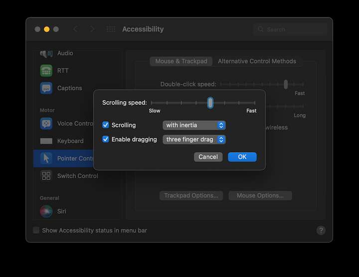

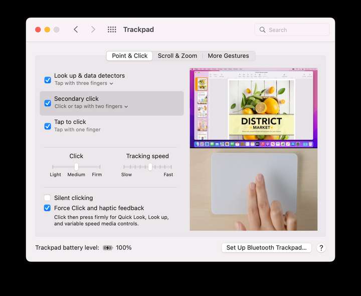

@VectorStyler Try this:
- Both click-to-tap and three-finger-drag must be enabled.
- Never press on the trackpad, don't use the physical clicks.
- Draw one shape on an artboard, then deselect it.
- Try dragging that shape without selecting it first. Just hover the mouse over it without clicking or tapping, then start dragging with three fingers.
- Deselect the shape by tapping-to-click once on the artboard (again, don't press on the trackpad).
- Repeat the above steps several times: drag>deselect>drag>deselect>...
