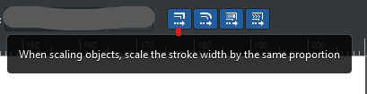

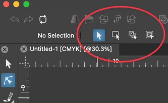

I really appreciate how in Inkscape this is solved by a toggle at the top of the screen. In this post https://www.vectorstyler.com/forum/post/17146 @VectorStyler indicated that it was added to the backlog, and as it may need a different option, for your consideration (these are toggles, all related to scaling, they appear super conveniently in the select & transform context menu, and of course not all are applicable to VS):
Yes, this is in the backlog for version 1.2
