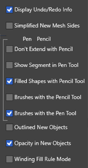

  • @ncic If you enable the 'Filled Shapes with Pencil Tool' option in Preferences > Changing Options, the shapes drawn should pick the properties of the previously selected shape.

    Should the 'Filled Shapes with Pencil Tool' be on by default in the future?

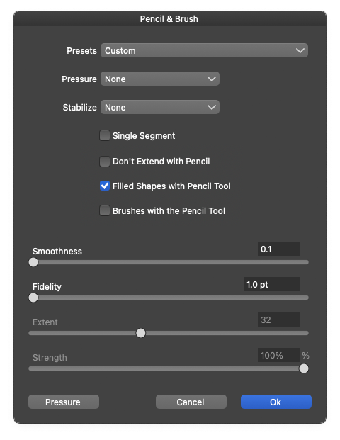

    on the topic of the locaton of the filled shapes setting
    • i agree having a tool specific setting like that it in the global program preferences feels a bit misplaced.
    • having it in the context bar is maybe a bit unecessary as you probably dont need that regular access to it
    • the correct place to have it would be in the pencil tool settings. when you select the pencil tool and press enter you get the dialog for the pencil and brush tool settings. this feels like the home for the allow fill setting. this is where i first went to looking for it and didnt find it.
    something like this

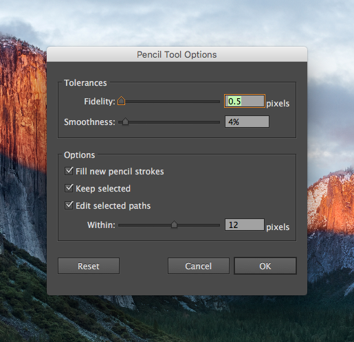

  • @b77 said in The pencil tool doesn't respect the fill and stroke color styling attributes set by the user.:
    @Boldline Which other vector apps have this approach for the Pencil tool by default (picking the stroke and fill of the previous object by default)?
    I stand corrected - Illustrator needs you to switch it in the pencil tool panel. Regardless, I agree with @ncic that it makes more sense to have this setting available in the pencil settings panel rather than buried in the preferences or taking up space on the contextual bar. If I was looking to edit the pencil setting to allow for an auto-fill, I'd be looking first in the pencil settings themselves.
