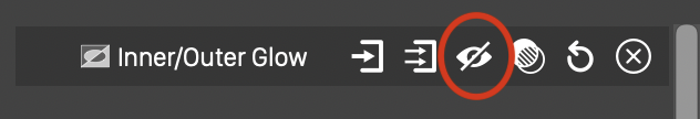

@VectorStyler Ya it was mistakenly turned off, still the effects was showing. But even after turning it on angle doesn't work. I think there is some issue.
@Jayanta-Das When it is off, the effect should be hidden. this is a bug, and the fix will be in the next build.

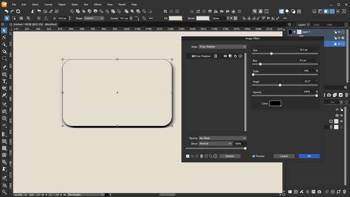

@VectorStyler Is the angle in drop shadow also for controlling the direction of blur and not the angle of light/shadow?
@Jayanta-Das No, the angle of drop shadow is the direction of the shadow.

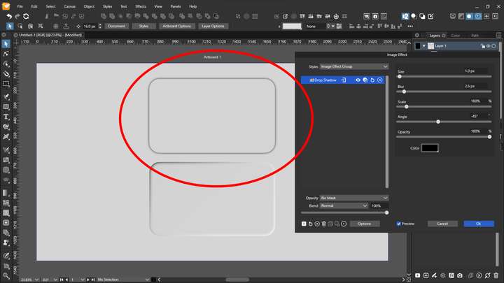

@VectorStyler What I am doing to do in create button pressed and normal state like the image below:
But when I apply outer shadow and increase blur it bleed to all direction.
I found the there is no offset of control of shadow like this.
@Jayanta-Das I'm not sure that it applies to this case, but in Drop Shadow there is the Size field that controls the offset.

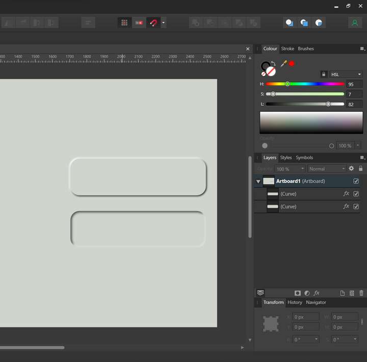

@Jayanta-Das As for the other images, I think these look more like using Emboss.
@VectorStyler Emboss effect applied within the shape. I am trying to get neumorphic style button where shadow and lights are applied to outside of the shape
Edit: When the button is in pressed state effects are applied inside the shape and in normal state effects are applied outside of the shape.
