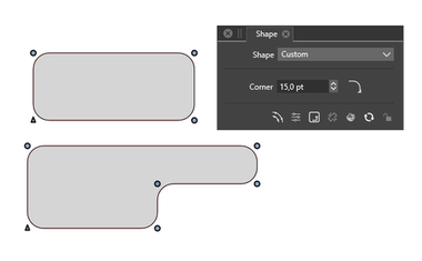

@Igull Yes, a rectangle made with the Pen tool is a "dumb" rectangle.
If I apply rounded corners to it then decide that I need to resize the rectangle non-proportionally,
bring the rounded corners back to zero (no roundness), then pressing 'Convert to Curves' resets
the rounded corner handles to equal distance from the corners:
It's a workaroundβ¦
A alternative way to resize a "dumb" Shape
and keep round Corners intact, is to do this
with the "Shape Editor Tool"

If you look at the Corner Panel > Panels > Corner
down below at the right side the X in circle
will delete all rounded corners from a selected shapebtw you can create a Action for the needed Steps
see pic below
( unwanted recorded Steps can be deleted in the Action Panel)
