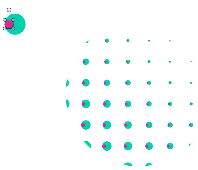

@VectorStyler I uninstall and install VS. The drag&drop is not yet functional but now I can change the small object and the changes are repeated in the 'repeater' large object. It is already something nice

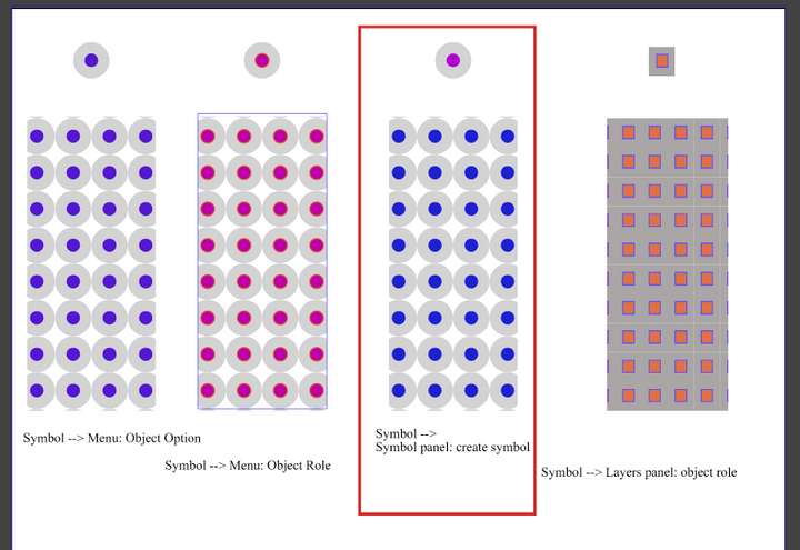

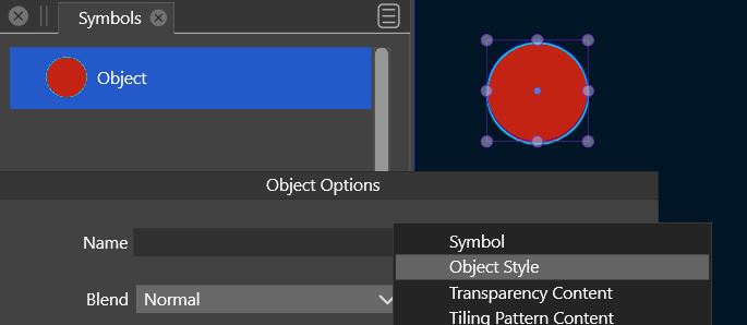

@VectorStyler I found another problem. The steps to create a repeat of a symbol is effective with a new document but impossible with an old one that I used to test various VS functions (the one I sent you a week ago).
@Pat Got it. I will try to replicate with an existing document.
@VectorStyler The problem may have been my old test file from the start. After reinstalling VS, I had created a new file and maybe that's why the repeater function worked. I can't test it anymore but it may have nothing to do with the fact that I uninstalled and reinstalled VS. If it is the file that is the problem, it is also annoying.

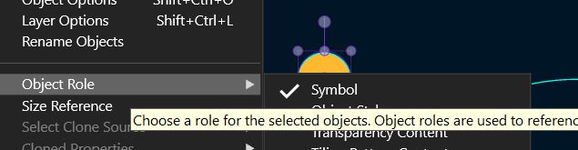

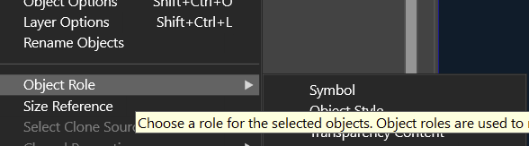

@VectorStyler Ok, got it, tested 3 times and reproducible: if the symbol is generated with the menu [Object--> Object menu-->...] as you described above, it is working fine and the change made to the small object is well repeated.
However, when the symbol is created via the Symbol panel, the changes are not repeated !!
It was impossible for me to be wrong every time.Edit:
I did not test through the 'Layers' panel. see below
@VectorStyler as I found it easier to define a symbol through the Symbol panel, I understand why I could rarely get the expected results... a somewhat tricky bug
