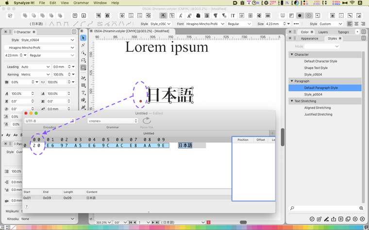

@vectoradmin
Similar issues occur on the Mac.
I will post it on Windows as well.I frequently change the input mode while working in Japanese. Input mode from kana to romaji, from romaji to kana. If you switch between them with the "kana" key and the "eiji" key, VS will enter unnecessary code there. In my case this was the cause of this problem. (Ref. Fig)
If you switch with [option + space], no extra code will be entered.
Evacuated resolution of this issue
The VS text consists of "Default character" and "Default paragraph". This is similar to Illustrator. (Different from InDesign.) Characterstyle is superior, so characterstyle is inherited without specifying some parts of the corresponding paragraphstyle.The first thing to do when working in Japanese.
Prepare your own "complete Japanese character style" and the corresponding "complete Japanese paragraph style".To change the mode while working, use [option + space] or pull down from the menu.
