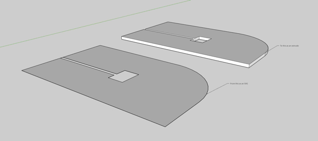

    Essentially, they are all a simple flat plate extrude from an object. They don't need shading or shadow.
    Neil
