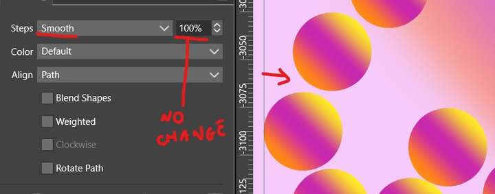

I think this is a bug or at least a non-optimal feature

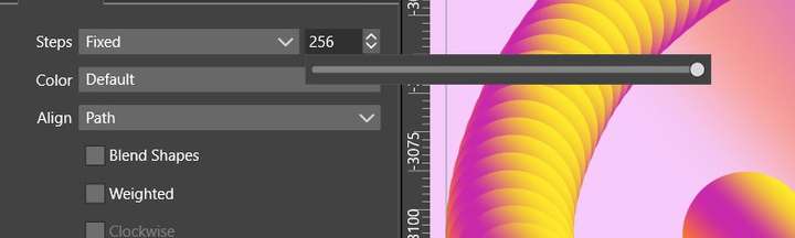

The number of copies in a blend is not optimal/sufficient when you don't want to see transitions:
Fixed:
@Pat Yes, this might be a bug, if the fill is not a solid color.
The problem is that having too many blend steps may impact performance, especially if the fill is a gradient.

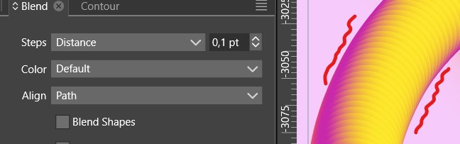

@VectorStyler It might be.
Indeed I do see a performance impact but I have 8 artboards with many complex schemes on each (many blend effects, image effects, etc.), so I'm thinking that for an artboard alone, wouldn't VS be able to handle smooth blends without any performance issues?:
@Pat said in Blend: smooth is not smooth:
That depends on the content of the blended objects. Gradients, for example, can slow things down.

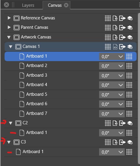

@VectorStyler How do I do that with a existing file? I'm trying to click and drag an artboard from a canvas to a new one but don't get all the objects (although unlocked) on/in (?) it.
Do I have co copy-paste all objects from an artboard to the one within the new canvas and delete the 1st ?
How can I visualise then the different canvas side by side ?Thanks
Do I have co copy-paste all objects from an artboard to the one within the new canvas and delete the 1st ?In the Canvas panel, select the artboard and alt+drag into another canvas.
In a separate view of the document (View -> New View) you can select a different active canvas.

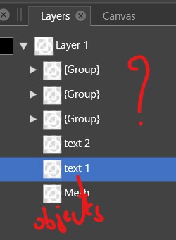

This will make things easier (can still pageup/down on artboards andor use the canvas panel).I've started to create several canvas in order to separate the artboards. The issue I have then is that I can only see the layers and objects of one canvas/artboard. I can't find the way to get all my layers visible in the layer panel whatever the artboard/canvas I select, it seems that the layers are empty... and every time I click to select one object of a 2d/3d/... artboard/canvas, VS comes back on the first one:
@Pat Each canvas has its own (different) layer hierarchy.
Yes, this is normal, Layers panel shows one canvas content at a time.
Is the active canvas also empty when the layers panel is empty?
I could not replicate this (tried with 2 canvases). Could you send a short recording of this when it happens?
This could be a bug.

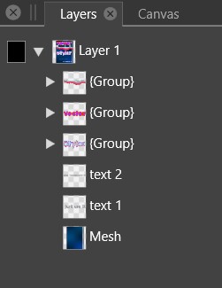

No, the artboards are all ok. I may miss something.
I send you the file
@Pat Got the file, and when I change the selection in the Canvas panel, the Layers panel content is updated to the current canvas.
But there is one thing that might happen here: how was the Layers panel opened?
If it is opened for a canvas (from the Canvas panel), that it is "glued" to that canvas, regardless of the current canvas.
Close all layer panels, and open one with the Panels -> Layers command, then select different canvases and check if the layers panel content updates.
