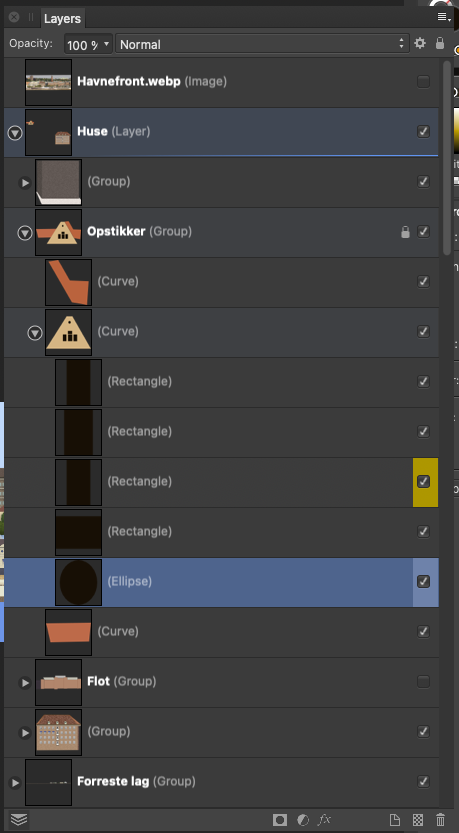

For me, I can definitely say no to the many attempts at improvement I see in Affinity and other programmes. They don't succeed because there is usually a confused effort with no science or UI education behind it. And yes, I work with usability every day.
Keep it simple!
In v2, Affinity has completely destroyed the most important thing in the layers panel for me, a quick overview of the content. A complete amateur chaos of lines and icons - and Serif did this because they think they can do without UI specialists. I don't lock, colour or hide objects all the time, but I navigate the left side of the layers panel constantly and all the time.
It is absolutely crucial for me that the structure of the content and thumbnails are easy to read for quick use (left side with no Linux grid and symbol spaghetti), and the name afterwards is important, secondary. After that, locking and hiding content is less important - on the right side, for WHEN I need it. Tertiary.
I guess this can be solved with customisation options, but basically my message is, FFS, don't ruin the current simple layout for me, which works great in designs with hundreds of objects.

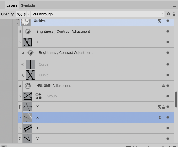

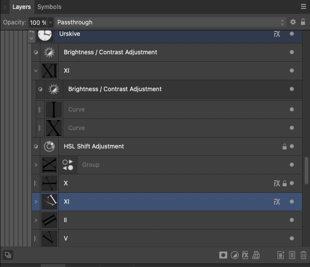

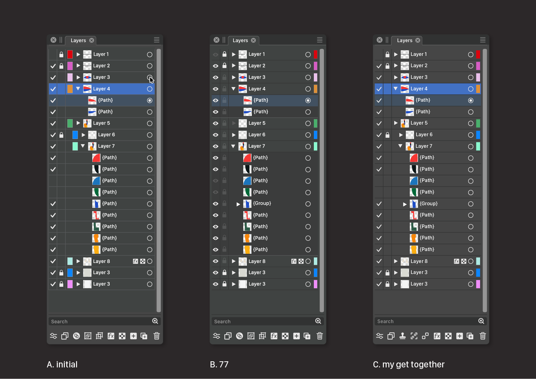

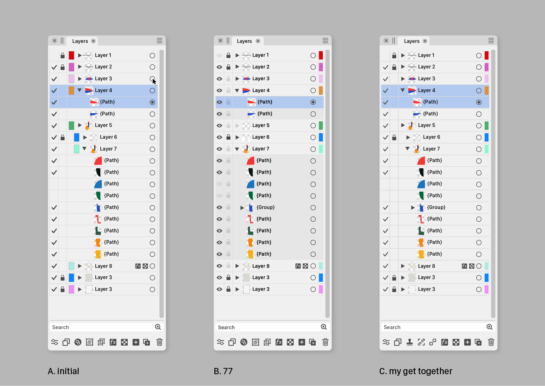

@b77 said in Ideas to improve the Vectorstyler Layers Panel:
@Ingolf If possible, can you include two screenshots with v1 and v2 of AD's Layers panel?
I searched them a bit but I'm not sure those I found are not from AD's Pixel "Persona",
which might look different (I guess).Version 2:
Pure crap UI:
Compared to the absolute calm and no nonsense interface in version 1 I NEVER had trouble using or navigating in. Everything from this point and 'up' should be opt-in.

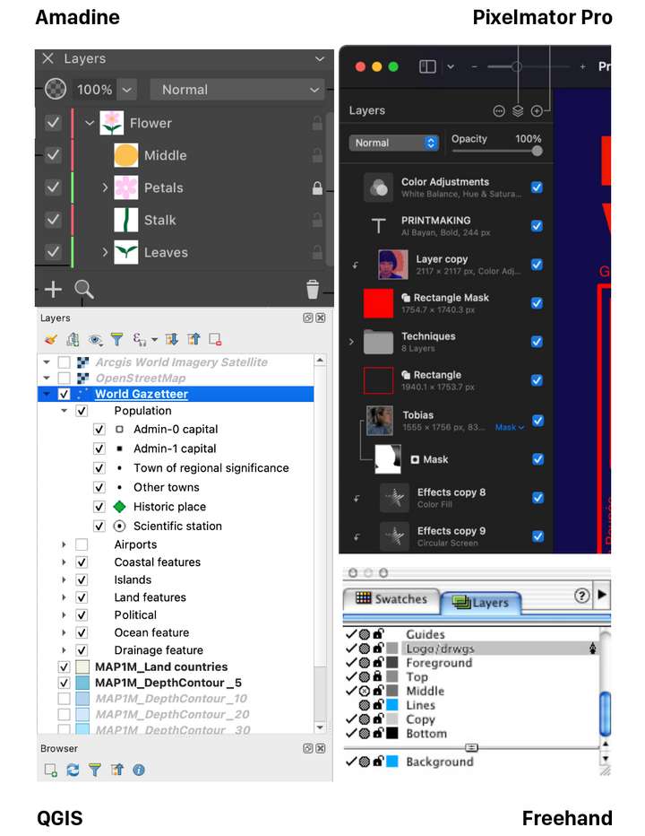

Are there other graphics apps using a validation sign in the Layers panel?
Came across this.
Nice variation. Layers panel –I suppose– on the left hand side this time. On/off (with checkmarks) on the panels right side, close to the users working center.From earlier post today: Toucan

a final argument for the checkmark : )
All right… in all seriousness, I have to acknowledge that there are indeed
vector-based apps that use a checkmark for layer and object visibility
(and export) instead of an eye. Some because the functionality of their Layers
panel is simple, some other despite the complexity (Affinity, I guess).To me a checkmark still seems too generic (it doesn't scream 'visibility').
Besides that, there are other places in the app where the concept of 'visibility'
is used (Hidden object, Show All Objects, New View, Select All Inside View),
and I don't think using a checkmark in the icons of these commands would work.(I'm trying to make icons for these commands as well, so we could continue
the discussion when I post them on the forum. The icons won't be perfect,
I'm sure).OK, said enough about this, I rest my case.
