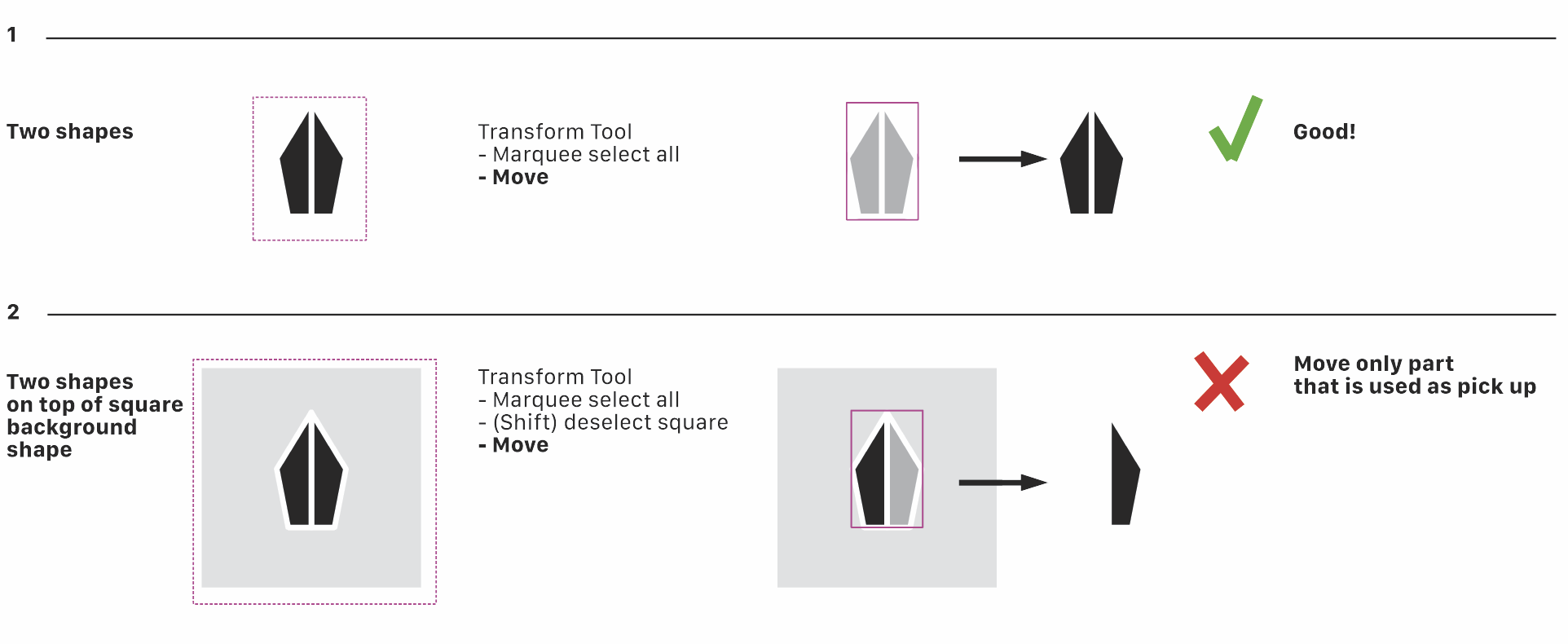

@Ayo said in Can't move combined selection:
@Subpath Sorry!
'Two objects selected' thanno problem
i just saw in your example that your Objects had
not the same color, which would be the case if
you combine them
so i though that you just mean selected, but was unshure
@Subpath said in Can't move combined selection:
not the same color,The gray is intended as the echo or imprint on the burial shroud of the moved item.

About your recordings: you both can do amazing things that I can't do.Glad my classic textbook explanation still works. Advantage over Screen Recording is the exercise in VS. Working with, text, arrows etc. (For example, I notice that during my explanation the text cursor in the text boxes does not always want to appear. But that is an other issue.)

@Ayo Moving or duplicating the two black shapes in the file works here as it should.
No idea what is causing this. Maybe you're using a stylus and not a mouse or trackpad?
