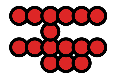

which VectorStyler Contour Tool does not offer.To get the Effect shown in the Video in VS your Circle has
to have a Stroke and "Use round joins on cusp corners" set.Here a video showing the principle in VS.
It also takes a bit more work to do this with the Contour tool
in VectorStyler than manually. But on the other hand, the
Contour Tool produces interesting results.

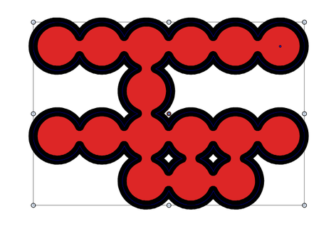

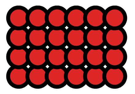

I gave the Repeater a go
Repeate Circles with a Contour and
"Use round joins on cusp corners" set like thisReduce the Space between them (in Repeater)
to get the Effect

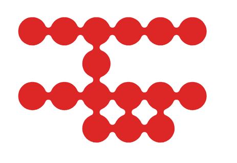

Expand the Result from Repeater and
delete the Circles you dont want to process.
Select the circles and do a Boolean Add.
