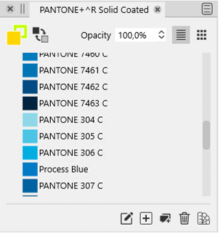

@Arde Probably a silly question, but can you tell me how you got pantone palettes inside VS?
In addition to .ase Adobe Swatch Exchange binary palettes exportable from Adobe apps VS also directly reads the .acb Adobe Color Book palettes that have PMS color definitions, and .XML coded palettes at least from CorelDRAW that also include PMS palettes. It also seems to support CorelDRAW .cpl palettes and some .csv encoded palettes (but not e.g. those included in Affinity apps):

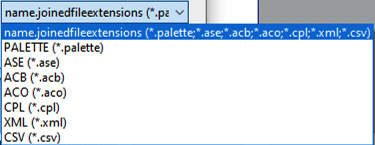

@Arde I noticed an error in that screenshot: the All Formats label resource was not defined
will be fixed in the next build.

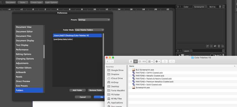

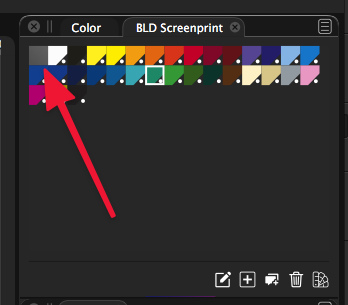

However, when I saved out my custom swatch palette from Illustrator as an ase file, when I open it in VS, it shows as empty. The screenshot I included shows the folder I'm using to store my palettes I want to use in VS, along with the preferences box in VS, and the empty palette panel . Am I missing something?

@Boldline Is it also empty when opened with Panels -> Palettes -> Open Palette File. If so it could be some bug when reading the ASE file. If you send me that ASE file, I will try to find out the issue.
@vectoradmin Yes it is also empty when opened with Panels -> Palettes -> Open Palette File.
I'll email you the ase file - thanks!
@Boldline Got the file, and it looks like there is a problem when reading this ASE file. The problem has been identified, and the fix will be in the next build.

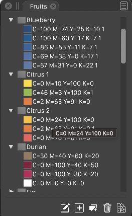

I tested this by exporting a palette with AI Fruits palette included in swatches, and VS imported that without any problems both on macOS and Windows. The source was created on Windows using AI CS6.
Is the error related to later version of AI, or having something unexpected in the swatches? I suppose AI automatically excludes gradients and the kinds of swatches that are not supported in an ASE file?

@Arde The error can be fixed in the ASE import of VectorStyler. Various Adobe versions are not very consistent when writing files, and in some ASE files the header info (palette name, etc) is missing.
