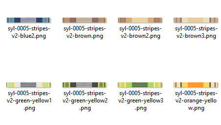

@VectorStyler said in Recolor woes:
Are you saving "presets" of the recoloring filter?
No. I just reopen the dialog and it retains my last used settings. Which is the starting point for the next combination. So I try a few iterations of browns (earlier range of colours of the palette) with randomization, and then move the index up to a next group of 4 (as there are 4 colours in this design), the blues, the greens, and so on ending with the yellows. It also means that ordering of the palette in a way that more attractive (harmonious) combinations can be found is useful. Remember that for my purpose I stay within a limited palette of selected colours.

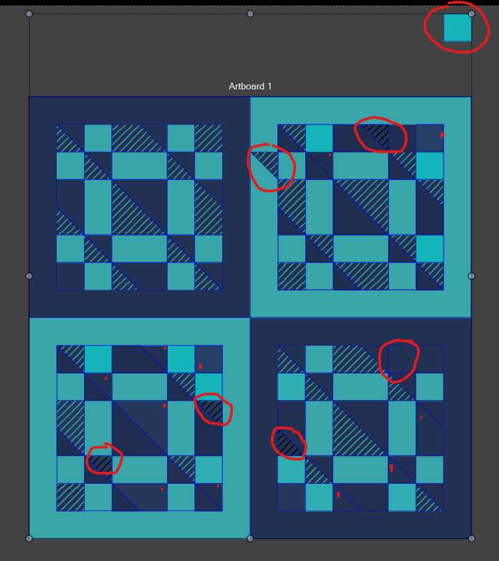

@syllie I understand, you just need to be able to change selection without closing the dialog.
@syllie The recolor view has been improved, it is still a dialog but it should behave better with the patterns.
@VectorStyler The issues with Replace Color > Color from Palette seem resolved. Still testing through but the files that were misbehaving before now get recoloured as expected. And cancel is indeed understood as cancel. Very happy with that!
