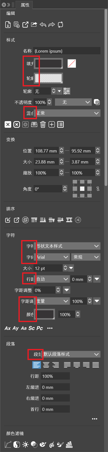

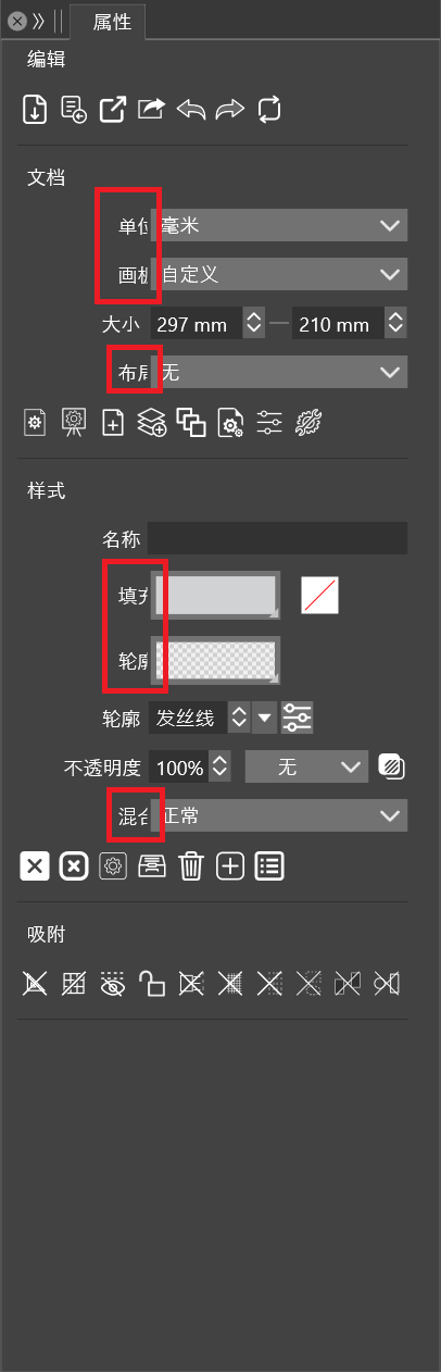

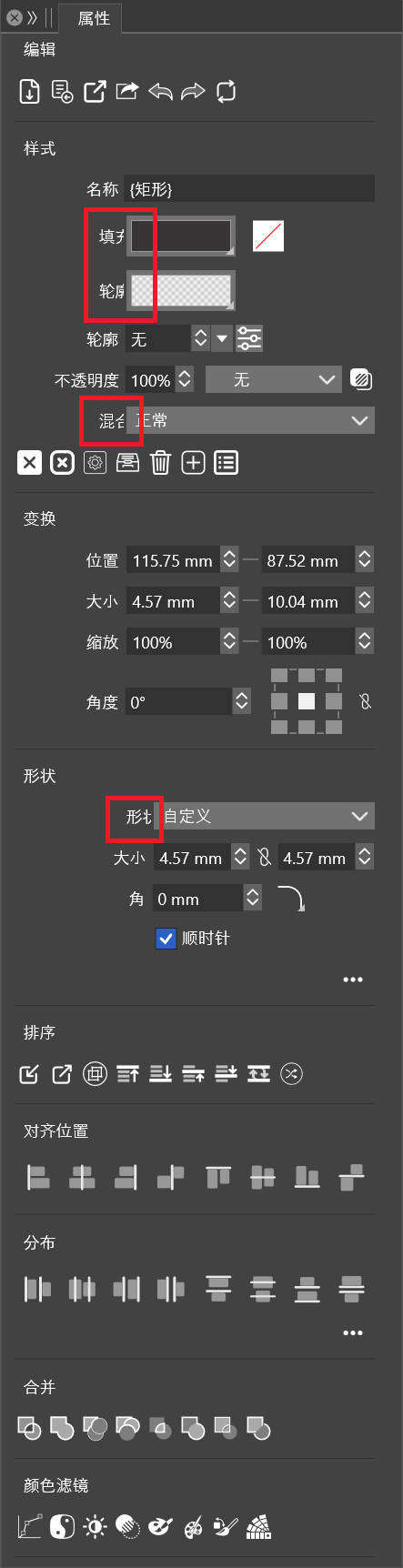

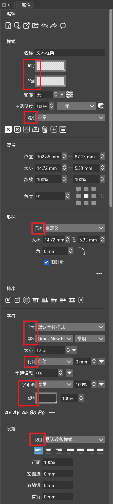

@VectorStyler An obvious issue with the Chinese interface is that the text is not fully displayed, especially on the panels. I have tried different settings and even set the system display to 100%, but the problem persists. I will review everything and point out the problematic areas.
Properties Panel
@Li-Xiao Got it, this seems to UI font issue on Windows. I will try to fix it for the next build.

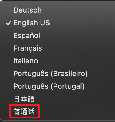

@VectorStyler Suggest changing '普通话' to '简体中文'
@Li-Xiao said in UI language translations (BETA):
Wil do so. There is also a UI font issue on Windows.

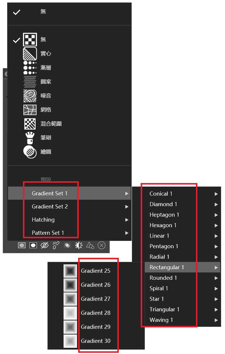

@VectorStyler The presets in the Mask options of the Transparency panel, Properties panel, and Image Effects panel are not translated.
@Li-Xiao Yes, most of these "extra" preset names are fixed (not part of translation).
I will try to add these to the translated text also.
@VectorStyler In general some things that are not translated can be: preset names, recorded or recent action names, and various names (like canvas, or layer) saved into documents.
