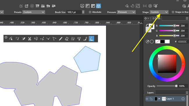

@Bitten You can try the Path Brush Tool and also the Eraser tool which do essentially what you describe.
You can change the size but (as far as I know) not the nib shape itself
you could change the Shape of the Path Brush Tool here
see Picture
.To create a user defined shape, just select the Shape you like
and give it a "Shape" Role.
Select your shape and go to > Menu > Object > Object Role > Shape. After this you
could select this Shape in different Tools of VectorStyler also the one i shown above

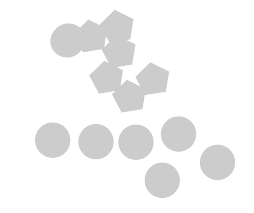

The shape only seemed to work when i was touching an existing shape. in my case here, the shape somehow changed mid-use and merged another star into itself....
its not your fault, got the same behaviour
it seems a bug
a single Blob could only set with the
default circle bloball blobs shape made via the "Shape" Role
works only if paint with it and then single blobs can
be set if there is a kind of overlapping. They dont work
as single blobs
