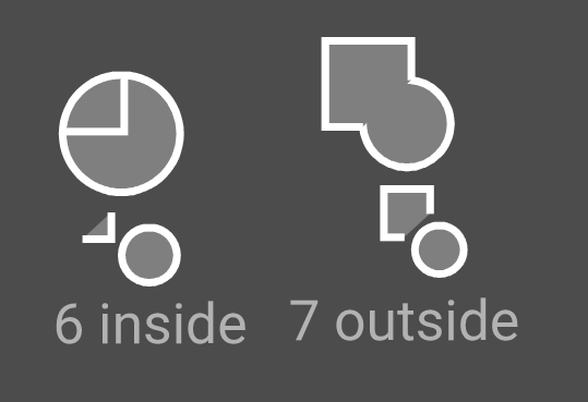

"Trouble" is VS has a few other special Combine commands (and their buttons) where the result depends on the selection order. Should each of them become two buttons for each case? The developer mentioned in another thread about using keyboard modifiers (Option, Shift, etc) for the Combine buttons — maybe the next build will bring that.
IIRC, CorelDraw has one button that subtracts the top object from the bottom by default, and I think it has the other option in a dropdown menu in a special panel.
I'd rather not have to open or keep open a special panel to access all the options.
So it's not that easy.
That doesn't mean I disagree — I also prefer the "visual" rule (which object is on top), not the selection order, and maybe use the reverse (bottom object subtracting from top object) when you Option-click the same button.
And if that button would change its icon to reflect the different result when you press Option…

@Aegis7 Again, for the Exclude button in VS I also prefer the top/frontmost object to subtract from the other object by default, no matter the selection order (so I don't disagree with you), but we have to take into account that sometimes the reverse is needed and seven or more separate buttons for the reverse action of the other buttons would be too much.
So what I hope is that the developer will instead use Shift- or Option-clicking the button if the user wants the bottom object to subtract/cutout/etc from the topmost object.
Would that be good? Bad? What do you think? That's what I'm asking.

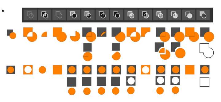

@b77 @Aegis7 @encart there has been some improvements in the arrangement and icons (thanks @b77 ) of these commands.
Also the Exclude Last option in the Path panel menu can be enabled to always exclude the last object from the others, regardless of the selection order.

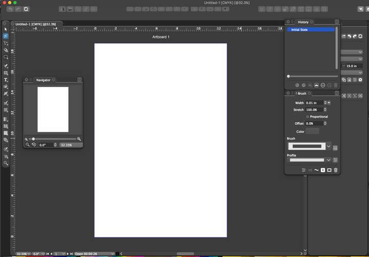

@vectoradmin Could the boolean operation icons be the same height as the other icons in the row?
@Boldline They should be. At least here they are. I will check on other MacOS versions.
@vectoradmin I'm still using El Capitan - if that helps narrow down the issue
@Boldline This is what I get on El Capitan:
@vectoradmin hmmm
I closed the app and restarted it - it appears smaller again on my end.... maybe it's something on my end?
@Boldline Send me the workspace.xml file from ~/Library/Application Support/NumericPath/vecvtorStyler1.0/vector/data/resources/ folder by email

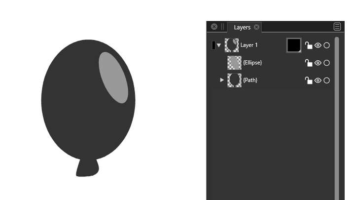

I dig out the topic.
I can't find what we agreed about the Exclude feature.
I know the principle , but it would be nice to improve it when the selection is done by dragging. In this case, the objects on top should cut out the object at the bottom. Currently, the opposite is true, and as a result, the entire object disappears. That may be confusing for new users.
@encart There is an option in the Path panel menu "Exclude Last". Once enabled, it will exclude the top object. The option will stay persistent after exiting and restarting.
@vectoradmin It would make more sense and be more user-friendly for this option to be enabled by default, IMO. It's a visual approach on the user's end, not a programmer's approach.
Also because of this, maybe also rename it to 'Exclude Top Object', because we think in these terms (top object, bottom object) instead of "The app counts the bottom object as the first selected and the top one as the last selected" (when selecting both with click-and-drag). We don't think like that.
@b77 Renamed to "Exclude Top Object" in build 1.0.048. And it is on by default now.
@vectoradmin Great!
