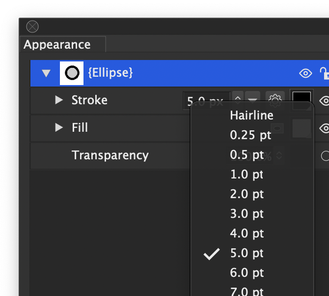

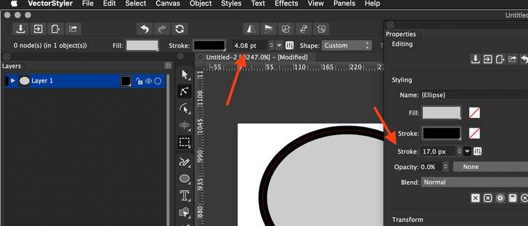

I do see a few areas where there are still PTs being used even though the document was set up in PX.
Stroke width (and the predefined popup list of values) - setting it to PX works though even with the drag slider.Nice work with the "Align to pixels" too
Added this to the bug list.
The problem affects some stroke and font size units, than can be set separately in the Preferences->Number Editors section.
Will make a more uniform design.
This has been improved, but:
- the unit settings for stroke and font sizes are separate and can be selected in the Preferences -> Number Editors section.
 - in the new release this is set to default, but existing installs keep their current settings.
 - to have the default units, select Default in the Preferences -> Number Editors for stroke and font units.
 - confirming (with enter) an other unit in a stroke/font size fields will set it globally also.
@vectoradmin this looks good too! It's still confusing to see the popup using PT when I selected PX in the doc setup.
Added to the backlog (stroke / font size popup menus).
New build fixes this (and several other issues) with unit selection.
