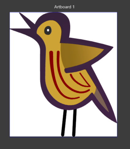

Export issues
This simple example

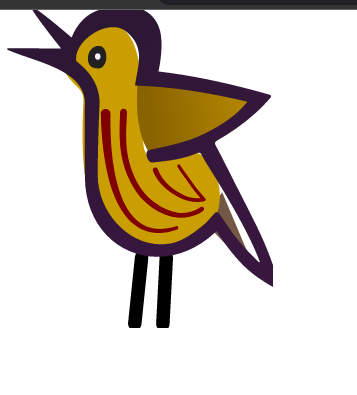

Looks like this in other professional programs - exported to SVG - or copy-pasted into them - this is from Google Chrome:

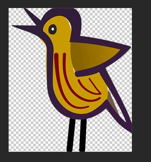

SVG imported into Adobe Photoshop most recent version:

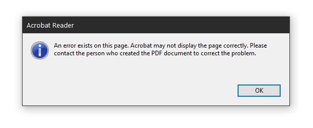

Exported to PDF (default settings or whatever I try) I get this error:

@Ingolf Because the drawing is so small, increase 'Precision' from 2 to 3 in the Export window, and the generated SVG file should display correctly.
But exporting as PDF places the objects somewhere off the page. This needs investigating by the developer. (It's great that you posted the file, btw).

The decimal trick mitigated the main issue, thanks!
@Ingolf I'm not suggesting you to change its size, just to increase Precision on Export from 2 to 3.
