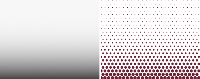

I created the grayscale gradient in Affinity Designer.
Then exported it as a .PNG and uploaded it to the Halftone Generator page.2
On the left side above at Shapes various settings can be made.
Choose there what you like. Also try Shape Distances.3
And then on the top right side it says "Download".
Click on it, a menu appears and choose Download .SVG.
Then you can download the whole thing as a pure vector graphic.
( The File is call halftone.svg )
( The Rasters are Vector Objects! No need to vectorize. )Experiment a little with different gradients.

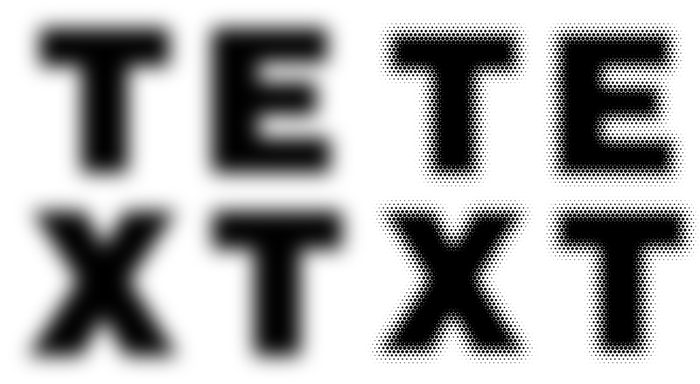

Found another Trick, this time with blurred Text.
This Tip whas originaly from a Inkscape Video
but i decide to try it with Affinity Designer.
( for the Video look at my Post below )-
Type Text in Affinity Designer
convert it to Curves. -
Put a Gaussian Blur Effect over the Text
and export it as .PNG. -
Upload the .PNG File to the Halftone Generator
and play with Shapes and Shape Distance. -
Download and save the Result as .SVG
Here my Examples
