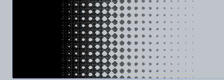

I'm getting this result so far: (gray is my artboard color in this image so the black is the only opaque part) Ideally I'd like to have the entire thing be solid black dots, not what we see here. Would this give me the result I am looking for?

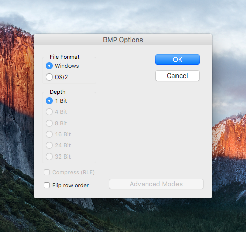

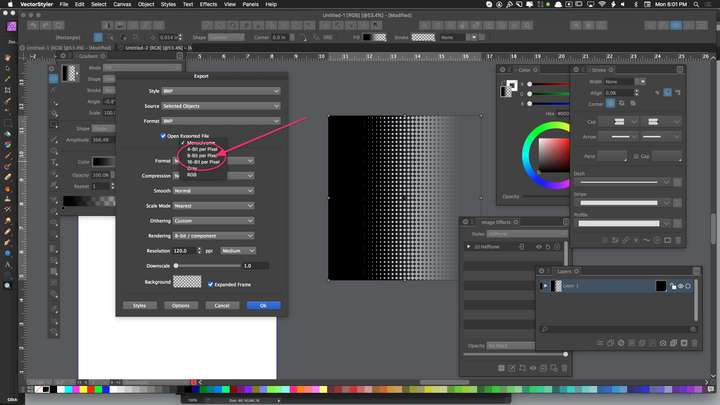

Comparing my settings in the export selection dialog box in VS, I'm not given the option of a 1-bit export the way I am in Photoshop:
@Boldline If the halftone effect gets exported as bitmap image at 1 bit, it would basically be an aliased (bitcrushed) mess, with only black or white pixels and no gray pixels for antialiased edges.
Is this what you need? If you want to auto-trace the result (vectorize it), the more bits the better the antialiasing will be.

@Boldline To avoid dithering for Monochrome, try selecting in the Dithering drop down, the Nearest option.

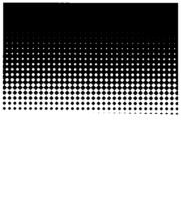

Setting dithering to "nearest" helped dramatically to remove the dithering issue in the halftone.

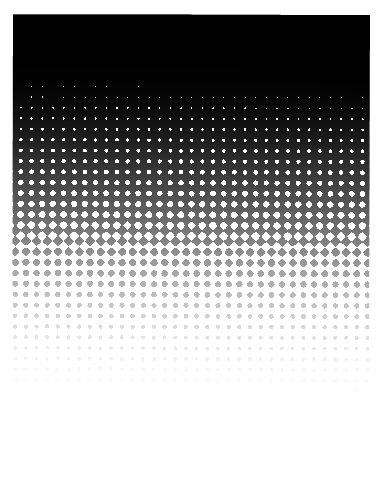

Here is the results I got:
I noticed it lost the second part of the halftone however - I assume because those dots were too faint.

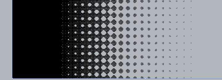

here is the original gradient made into a halftone inside VS before exporting:
I removed the white by lowering it's opacity to zero. It did still leave me with a halftone pattern that has an obvious fade to it. What would be my best option to get a one color gradient halftone - where all of the halftone dots are a solid fill and not fading as can be seen in the screenshot?
@Boldline Can you send me a vstyler file with this halftone effect? I will try to replicate the issue.
The second image has a smooth gradient (grayscale) behind the halftone, that will not export to monochrome as it is.

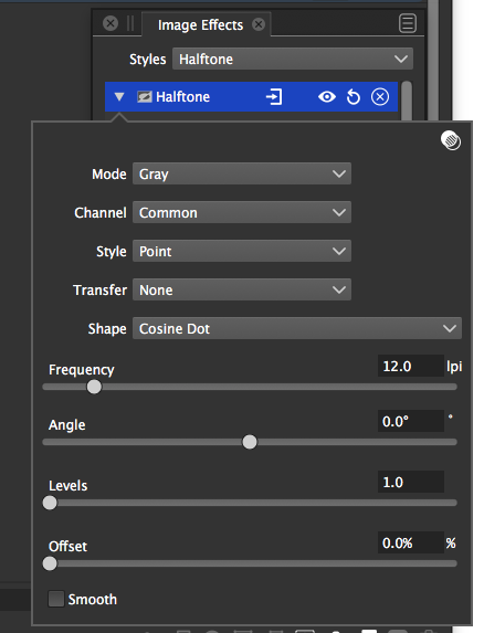

My goal is to have transparent one-bit (one color only) halftone bitmap using gradients in VS to accomplish this. I've been trying "monochrome" and "gray" settings in the export panel - but I do not think that is the same as 1-bit. When I use the "opaque" setting in the gradient panel, I get perfect full halftones - but not true 1-bit because the white remains with the black. If I switch the setting to "transparent colors", I can remove the white in the gradient, but it also affects the black and the remaining black fade itself becomes transparent leaving me with the result in the screenshot below...
I was also thinking a threshold option might help in the halftone section of the image effects panel
And a true one-bit option in the export panel - so that even if you have a two color halftone (opaque white to opaque black) the default 1-bit setting would automatically remove the white and keep the black by default.
@Boldline The Halftone effect is wysiwyg — if you don't see the white or black dots/parts as transparent dots on the canvas inside the app, exporting as 1-bit bitmap won't create that transparency. And since the app doesn't include a 'Color to Alpha' adjustment effect yet, I don't see any possibility to get strictly black-and-white transparency like that – you would need a 'Color to Alpha' effect that replaces white or black with full transparency.
So don't bother with masking the halftone with a gradient — if you don't want the semi-transparent grays it's not the right method.
I would approach it like this:
- assign a gradient fill to the object (any contrasting colors will do) and leave the opacity at 100% for both color stops;
 - apply the Halftone effect, with 'Gray' mode;
 - export the object as lossless bitmap image (PNG);
 - open it in a specialized image editor (Photoshop, GiMP, etc);
 - apply a 'Color to Alpha' adjustment where you select white or black to be replaced by full transparency;
(For people who don't have access to a commercial bitmap editor, GiMP has 'Color to Alpha' in the Colors menu).
