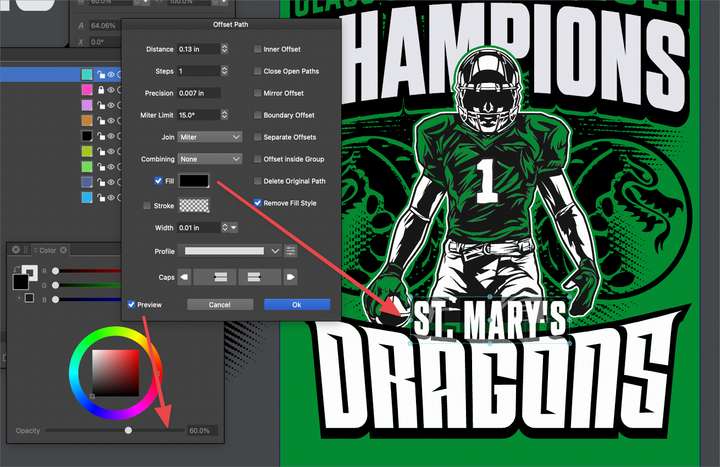

  • One of the things I really love in Offset Path in VS is the secondary click on the preview checkmark to get a lowered opacity preview of how the offset path will look prior to committing to it.
    However, if I use this feature, unless I change it back afterward to the regular preview, my final result will be at 60% opacity and I have to pull the opacity bar back up to 100% again each time. That to me is unnecessary extra steps. It would make more sense to me, that the offset path automatically return to 100% opacity since that is typically where it started out from when the original share was selected. I don't know if maybe the rule is that the end result mimics the opacity of the initial selected shape being given the offset path treatment? So if the source shape is at 90%, even if you do the low opacity preview inside the Offset Path panel, it will output back at 90% upon completion. Same is true of shapes that begin at 100% opacity and the low-opacity preview is used - the final result is at 100% automatically
    @Boldline This looks like a bug. It should return to 100%, and if I try to replicate it, and it did return to 100%.
    I wonder if this is again an issue that requires a restart.
    If there is some example that would help replicating it, please send it by email.
  • @vectoradmin Yes restarting solved it. Sorry about that.
    @Boldline I got to get to these (need for) restart issues at some point.
