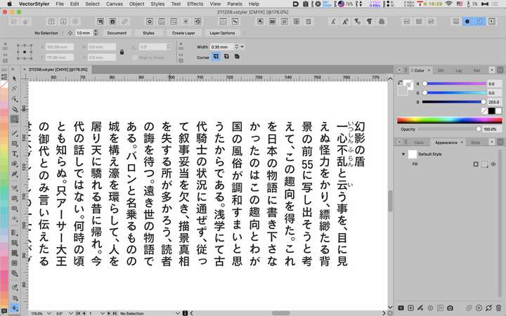

Vertical text in PDF is not proper
Punctuations in vertical text are shown in the wrong position.
Tate-chu-yoko text and Rudy text are also in the wrong position.

In my environment, they do not happen. (Of course, this is a working screen.)
This issue should be resolved in ver. 1.0.023.

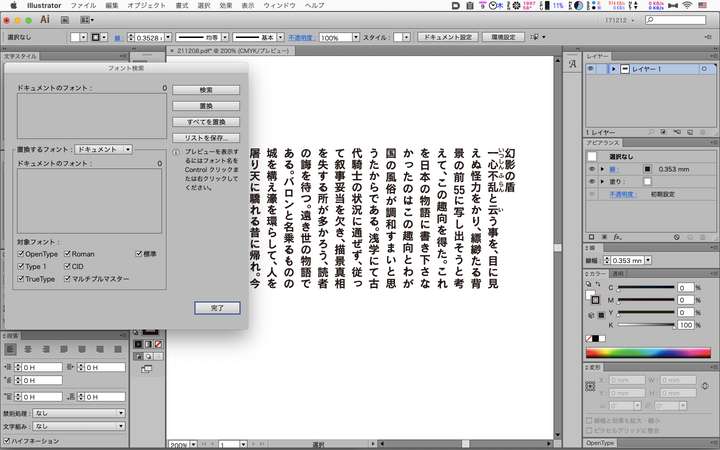

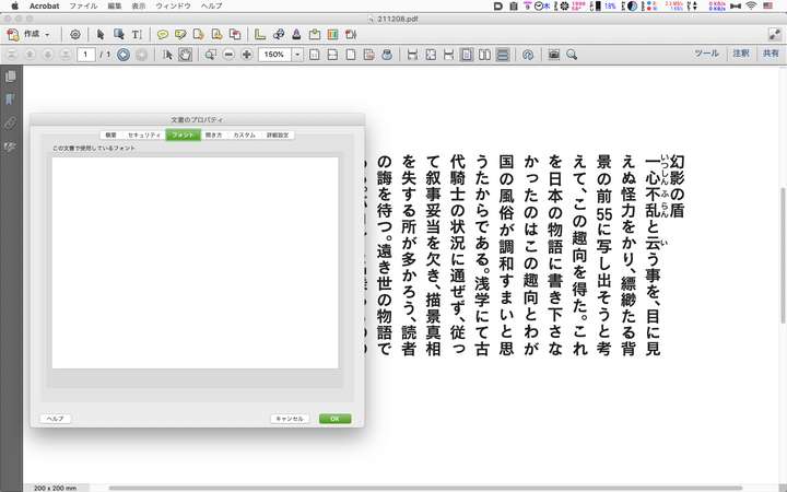

Export the artwork as PDF and open it in Acrobat or Preview.UPDATE: I just tested on Mac and it's not even shown or opened.
@ash-f
@vectoradminI don't have that problem in my environment, nor have I been able to reproduce it.
I have opened it in Acrobat and Illustrator.
The problem doesn't occur because all the shapes that VS exports are pathified.
(However, I have another problem where I can't embed a subset without pathing it.)Acrobat
Illustrator
@861475_VctSt It could depend on the font used.
Have you tried Yu Gothic?Acrobat can't open a pdf KozGo or Noto Sans used on Windows.
