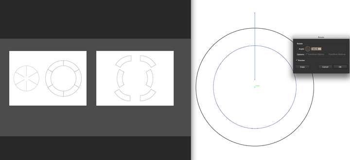

  • @Subpath In AD, i created the 'Donut'' with two circles to the dimension width i would need for a frame etc.. set out lines , and then expanded the stroke then broke apart.
    I know what you are saying with the clip board etc, but im the type that just wants to get the design job done as fast as posible and bring my work into the real world and get it to the Client or into my shop, and not wishing mess around with copy to clipboard , use this software , then use that software because , its just another interruption in my workflow for me that i dont need, time is money .
    Im not too keen on AD at the moment , Theres no shape building tool and a few other things im not too keen on , but as with anything , i am playing around with it.. VS just seems to feel better , if you get me?..At the end of the day , im totally used to using adobe products and there is a learning curve with any new software.

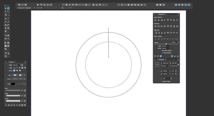

  • @GlassWorkshop VS has rotate-with-copy from the Object menu > Rotate — just…
    • draw the line horizontally (with Shift);
    • choose Rotate from the Object menu;
    • in the Rotate window choose Apply to 'Copy';
    • change the angle to 60°;
    • change the Repeat value to 2 (two copies);
    • click OK.
    Quick video here: https://recordit.co/e5wkyfsVXf
    And there's another (easier?) way to do multiple slices, not involving lines:
    • draw just one slice of a circle with the Ellipse tool by clicking the canvas once and changing the second Pie value to 60° in the 'Ellipse' settings;
    • with this slice selected, go to Object menu > Rotate and…
    • choose Apply to 'Copy';
    • click the transform gizmo so the object is rotated from the lower left corner of its bounding box;
    • change the Angle to 60°;
    • set the Repeat value to 5 (five copies);
    • click OK.
    Quick video here: https://recordit.co/6OQAaO3kZF

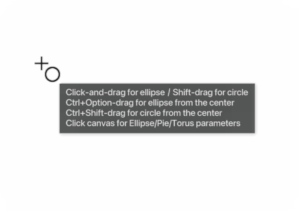

    I guess @Subpath refers to a tips area in the UI (already requested), where if you hover the tool or selected it already, you can see a concise explanation about how to use it and what it can do. Something like…
    Click-and-drag for ellipse … Shift-drag for circle … Ctrl+Option-drag for ellipse from the center … Ctrl+Shift-drag for circle from the center … Click canvas for Ellipse/Pie/Torus parameters
    Tried to make it as short as possible and it's still long… Can it be made even shorter than this? 🤔
  • @b77 Ok, I think I understand - sort of like what Affinity has at the bottom of their screen with suggestions for what you can do next with whatever tool you are using?
  • @Boldline Yes. Or would a(n optional) tooltip tied to the cursor be too much?
  • @b77 That feels like overkill to me. I'm not even a big fan of Affinity's model for doing that. Personally I feel like just listing the name and super pithy description is sufficient and then have a robust documentation pdf that explains more than what is in the current documentation. One small example of this for me is more use of the "breadcrumb" map- showing the steps to get to a certain item ie: Panels>Editing>Guidelines
