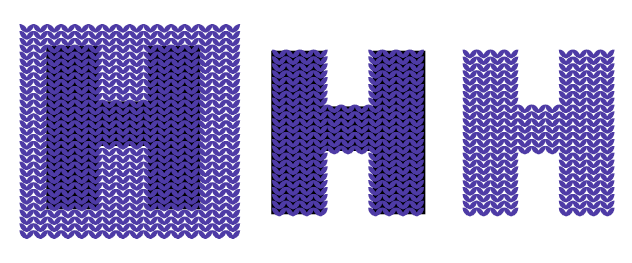

But why don't create an array of your pattern, put it over
the letters of the font and delete all the objects that overlap
by hand ? So nothing is cut off like with the clipping mask.Here is an attempt of mine.

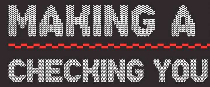

@Boldline It is doable with Repeaters. Still a bit slow, but it can be expanded once all attributes are set:
0_1639482524952_pattern1.vstyler
@vectoradmin Interesting! But I would disable font preview on the canvas with this — it froze the app here and I had to force-quit.

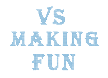

Could not resist
Have use the File from vectoradmin.To make this picture, i had to combine
three VS-Files for the Text.But that the text remains editable, even
with this pattern on it, leaves me
speechless!The Picture was build from
three Bitmap Files.
