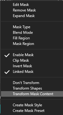

When I right click on the mask in the layer panel, there seems to be an option to "Transform Mask Content" as shown.
Assuming that by checking this option would help, this seems to have no effect and I can't seem to select it anyway.

Besides enabling 'Transform Mask Content', in the same Appearance panel select the Fill attribute, then from the panel's menu choose 'Transform Content': https://recordit.co/Wzuwd9ZJRQ
Also: if the transparency mask is a pattern, I would disable 'Absolute Origin' in the pattern's properties.
If this doesn't help, you can post a test file here on the forum (click the last button named 'Upload File').

Thank you - that did indeed do the trick and the transparency mask now scaled with the object. I would like to suggest, though, that this option should be checked by default. Affinity Designer has option on the toolbar, at least for clipping masks, to check a box to lock the children to affect transforms for the clipping mask and leave the contents inside unaffected. Maybe could something similar for transparency and clipping masks.

So, today I updated VS and went to scale an object with a transparency mask again. Although the "'Transform Mask Content" option was checked in the Fill attribute in the Appearance panel, the transparency mask was not scaling with the object again. I found the option in the Transparency panel menu. Once I checked the "'Transform Mask Content" option there the transparency mask once again scaled as expected.

@Qode5 One issue that happened here is that when scaling some shapes (rectangle or ellipse) the object is not scaled, only the shape size is adjusted, which blocks the mask scaling.
This is fixed bow in build 1.1.002, by always scaling the object if it has a transparency mask.
