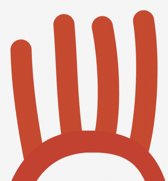

Export of lines changes colors
- When I export these vertical brown lines in the original drawing, their stroke color is exported as the same orange as the circle
- When I export these vertical brown lines copy pasted as a new document, their stroke color is exported as black

This is what I experience with the attached file (macOS 12 M1)
AttachedThis is what I get doing the same with the original document:
@Ingolf Send me the resulting orange.svg file, some thing is wrong with those colors.
this is what I get:
@vectoradmin said in Export of lines changes colors:
this is what I get:Clue: After expand stroke the problem disappears.
