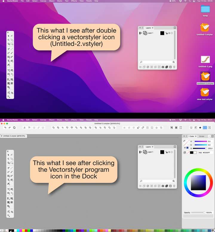

I also have experienced no content but only when opening when opening from a file icon.
If I open from the File menu all is ok.
After double clicking the icon I am not automatically taken to Vectorstyler, only any floating panels are displayed.
This happens both when Vectorstyler is already running and when closed and with any previously saved file, ie not just ones created in beta 1.1.

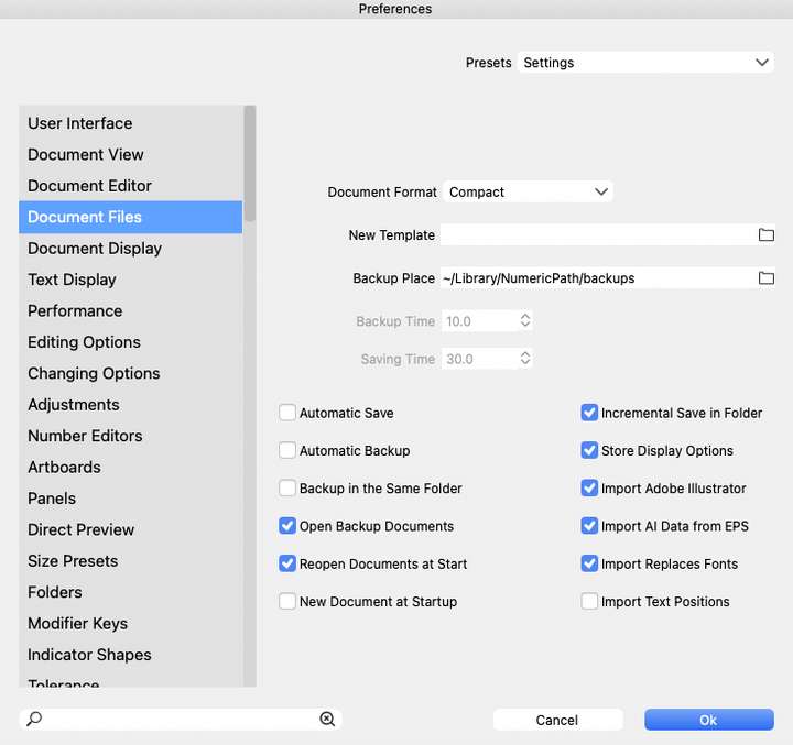

@Jono When VS is opened, it should have the empty application window. Was this changed in preferences?

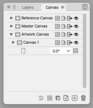

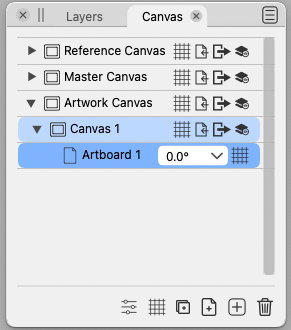

It might be some conflict with a settings from the previous version.One thing to try: open a file, and open the Canvas&Artboards panel, is there a "Artwork Canvas -> Canvas 1 -> Artboard 1" ?
Here are my preferences for opening documents:
Here are screenshots of the Canvas & Artboards panel. The first is when no content shows, the second is when the same file opens normally:
