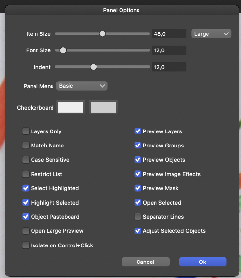

@vectoradmin said in Layer / object must be highlighted to be hidden / visible:
@Ingolf Try resetting VS by starting while holding Shift+Option+Command
Issue is back - but probably related to this combo of settings:
De-selecting "Adjust Selected Objects" mitigates the issue.
@Ingolf This issue should be fixed in the new build 1.1.002 (beta)
Verified as fixed!
