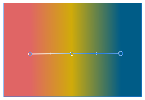

    One thing that Affinity got right is a very simple gradient editor:
    You have a start and end stop, and they mark the beginning and end of the gradient. Elegant, simple and intuitive.

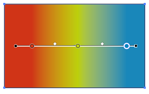

    VS and Illustrator both use an additional start and end point. I don't need that nor do I understand that approach. It adds visual complexity:
    Illustrator:
    VS:
    I suggest simplifying the gradient editor like Affinity by removing these start and end nodes.

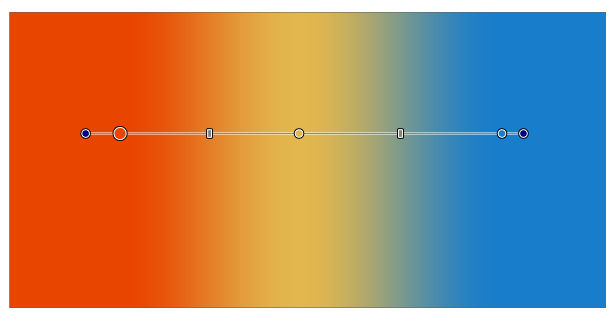

  • @fde101 Simply reducing the entire gradient relative to the object changes the distance between all color stops.
  • @Ingolf I was preparing to send to the developer an animation with a suggestion for a more functional (and thus a bit more complex) gradient bar, and here you go asking for a simplified one… 😆
    Maybe poor visual differentiation is what you guys don't like…
    If you ask me, the problem with the handles at the ends of the gradient bar is that they look too similar in size to a color stop, creating slight confusion. Besides that, they are colored…
    In my opinion…
    • making all color stops visibly bigger than the handles, and…
    • turning the simple line between the first and last color stop into a wide ribbon, so you can clearly see the gradient limits/ends…
    …would make the gradient bar look better and help with visual differentiation.
    Something like this:

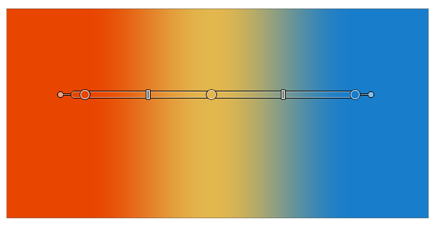

  • @b77 said in Further improving the gradient editor:
    Anyway… if you ask me, the problem with the handles at the ends of the gradient bar is that they look too similar in size to a color stop, creating slight confusion. Besides that, they are colored in that non-neutral blue…
    In my opinion…
    • making the handles slightly smaller,
    • making all color stops bigger, and also…
    • making the "ribbon" between the first and last color stop wider, so you can clearly see the gradient limits/ends…

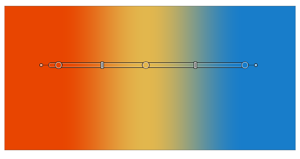

  • @vectoradmin Another slightly different version, with small squares for handles and thin lines from the handle to the start of the gradient ribbon:
    (I'll send the animation with further suggestions before the end of the year, I hope).

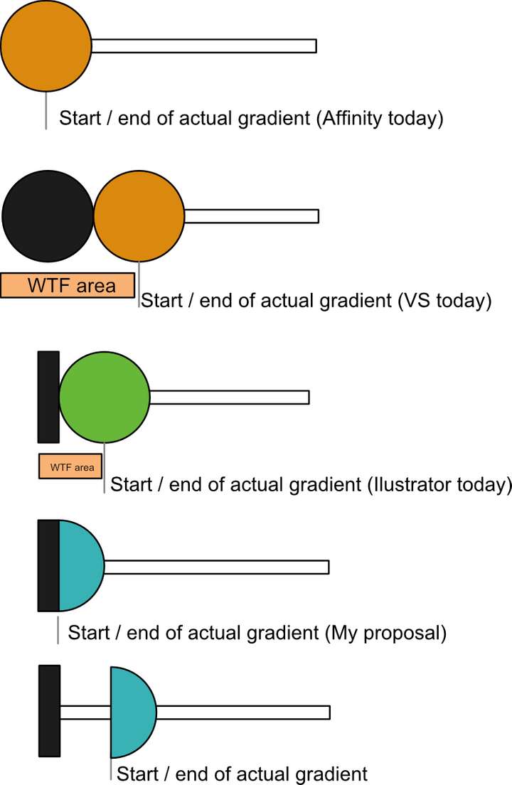

    A suggestion. The problem I have with the Illustrator method is the area between the gradient areas start/end point and the first/last gradient stop. I get a start-start point and a start point: the first gradient stop. It is so 1988 to me. I find it highly annoying (!) when using Illustrator. I am adapting to a machine not the other way around. Moving the first gradient stop to mark the ACTUAL starting point makes total sense to me. One start. One stop.
    I have a suggestion that at least makes some visual sense.
    Not sure it solved the compatibility issues though.
    But still. The Affinity way is the total Dieter Rams experience. Easy to understand. Easy to use. Will last for decades.
  • But anyway - if a million Illustrator designers are used to the way it works now, I am fine with it. In that case I suggest using a rectangle as start-end symbol like Illustrator. 🙂
