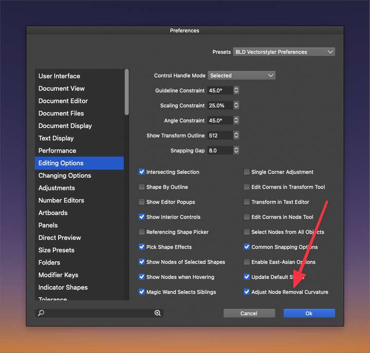

At first, I was not interested in using the "Node Removal Curvature" in my work. Usually I wanted nodes deleted and did not like that it did not give me crisp results. Later I realized there was a great value in being able to use it to make quick edits to curved paths in particular. I still find myself needing to switch back and forth between having this feature on and off based on what I am editing. If I am deleting nodes from a straight path, I like to have the setting off so it does not make the line wonky. When I am editing curved segments, I like to leave it on... I switch often enough that I wish the toggle was not buried in the preferences. I also do not want to clog up the space in VS UI.

@b77 I think it's the opposite way from what you said - if I enable that setting in preferences, then each time I go delete nodes, the remaining path and nodes adjust. This is great for curved paths in particular.... but when I want to do no-nonsense just delete nodes and make the path that remains straight, I turn it off.

i think what I'm wanting is a way to quickly toggle between the node removal curvature and standard deleting of nodes while maintaining the integrity of the path if that makes sense.
