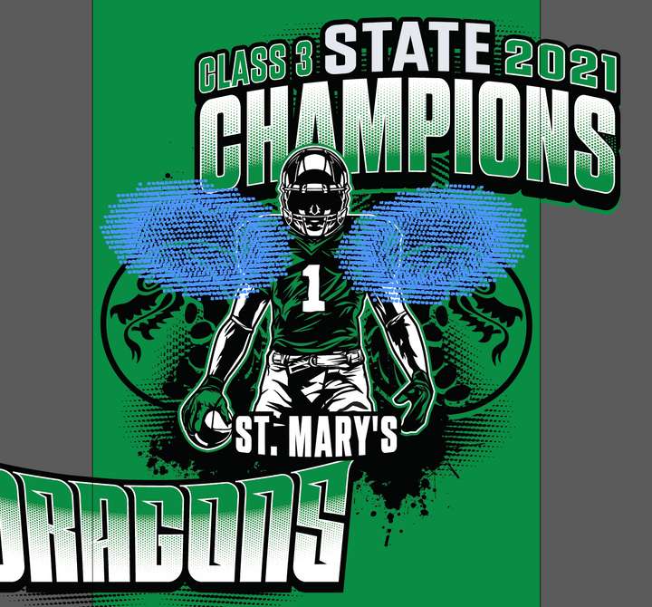

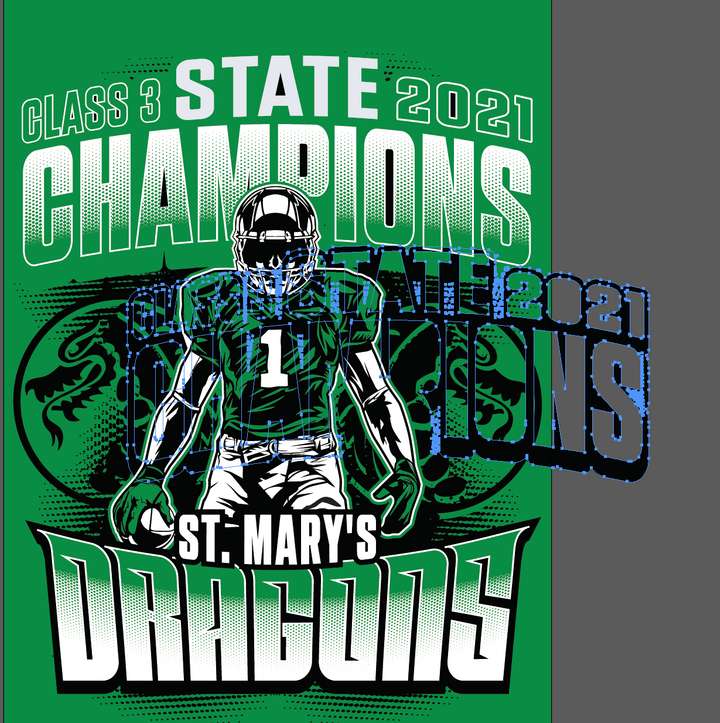

    Jumping back to this pertinent discussion from a while back... It makes sense that break apart is useful with combine operations and separate path works with composite shapes.
    So going back to my recent example with the owl mascot and the yellow rectangle being merged... Wouldn't that result in a composite shape?
    After merging, I pulled the yellow rectangle over and the mascot had been "punched out" but the entire rectangle acted like one composite shapemi would assume separate path would be the way to break it apart?
  • Are we better off adding an option to be able to remove styling when merging? If I understood him correctly, @vectoradmin had mentioned that one reason it was hard to compress down was because it removes styling.
    There's a time for styling to stay and there's a time it would be important to choose to remove it. A way to commit the styling permanently and no longer is the vector a live edit option.
    This already happens in VS in other areas... For example, the warp tool is not permanent until you convert to curves. Same with using the shape effect and image effect panels... Those options are always editable until you committed to it with a destructive option. Whatever styling was done with the tool, became permanent and the vector kept that effect.
    Could this be an option overall? The ability to select everything and while merging or before merging, a "strip styling" option could be applied?
    Would this clear the way for an easier time compressing everything down?

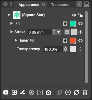

    @b77 said in Exporting Final Art from VS for others including non-VS users:
    @vectoradmin What happens to a regular fill once it gets this effect that moves it to the negative space? Is it disappearing, and you need to assign another one in its place?
    Yes, once this negative space effect is added, the fill it is added to will show the negative space. Maybe, an option (of the effect) could be to keep original of there is no negative space.
    Otherwise, to have the original visible, there must be an other fill without this effect.
    Just like any other shape effect added to a fill (or stroke) content.
    The typical workflow here would be: add an extra fill, and add the shape effect to this new fill, so the original shape will remain filled.

  • @vectoradmin said in Exporting Final Art from VS for others including non-VS users:
    I wouldn't say that going inside a menu with submenus to add an effect is fast, and it is not easily discoverable either. Discoverability…
    Option-clicking the regular 'Add Fill' and 'Add Stroke' buttons, OR choosing 'Add Inner Fill' and 'Add Inner Stroke' from the Appearance panel's menu seems more straightforward to me.

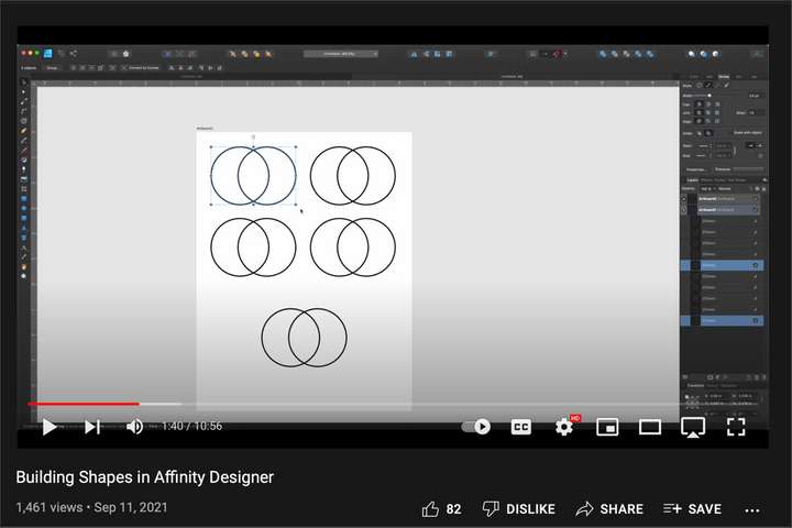

  • This video applies to a few of the conversations on the forum - but for now I'll add it here.
    This is the "Live Paint" option in Illustrator for filling in negative spaces inside expanded vectors.
    You select the vector first - then select the live paint tool and then you can pick a color from the open swatch palette or there's a mini-selector as part of the cursor where an arrow key left or right switches between colors in the color palette.
    As you hover over the selected vector, it highlights areas you can click to fill. It's a "live effect" and when finished you have to expand it (same as convert to curves) and then ungroup it.
    By no means do I think this is the best solution but I do feel like it's a step in a good direction and might tie in with the idea you were suggesting @b77 for an option to fill negative shapes that is still "live"

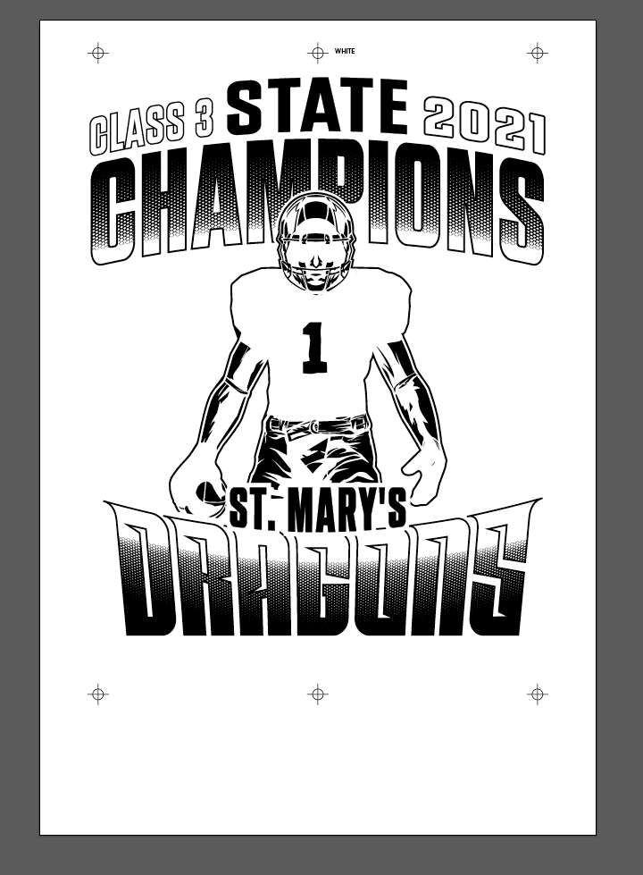

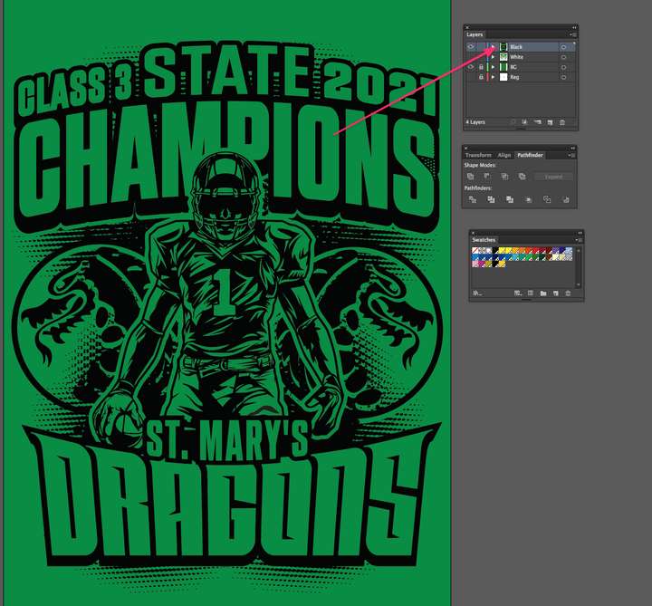

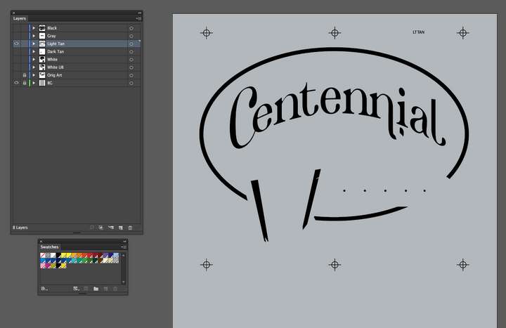

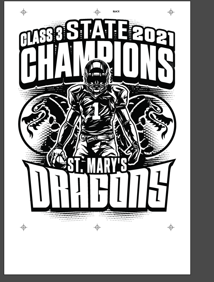

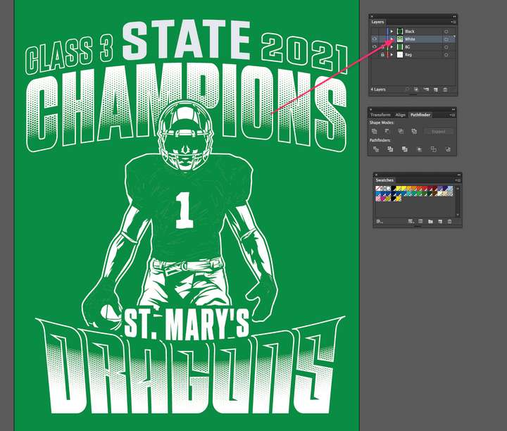

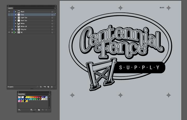

  • @b77 This is a screenshot of what a typical separation job looks like for me in Illustrator.
    Every color in the job (this job has five colors and a white base) is on it's own layer.
    The gray background gets turned off, I use that as a standard background color when prepping everything.
    I convert each color layer to a dark opaque black. and then when I send this to the client, they will turn off the original art layer and the background layer and then turn on each color layer one by one and print onto films

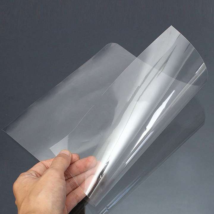

    This is what it looks like when you print films:
    So the black needs to be super opaque so it can block UV light from exposing that portion of a screen coated in emulsion. The UV light hardens the exposed emulsion and the part covered by the black ink on the film can be washed off easily, creating the stencil used for screen printing
    ![0_1641165049340_d67920ec-4454-4c2f-ab1b-6e6f692533c6-image.png](Uploading 100%)

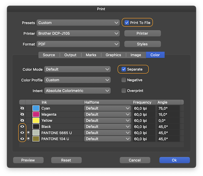

    I think separations done in VectorStyler work for what you need — if the object has an uniform, opaque black (C0 M0 Y0 K100), or an opaque spot color, exporting the separations to file will result in correct PDFs with 100% opaque colors for each ink used in the drawing.
    You might however want to open each PDF and combine some objects, for complete flattening.
    I'm attaching a simple VS file with black and two spot colors. If you use the settings below when printing, you should get three PDFs for all three inks used in the drawing:
    0_1641215535241_spot_colors.vstyler
  • @b77 This is really awesome! Yes this is a CTF (Computer-to-Film) workflow. I did not know the technical names and I wanted to be sure I explained specifically how I export vector designs and for what purpose and on why they need to be opaque, etc...
    I downloaded your file and edited my settings and it produced the three pdfs as you mentioned - this is a lot like what I would do in Illustrator when I printed films while working at a screen print shop (instead of just doing the art in my office working for myself now) so I'm understanding completely what is happening - thank you for showing me. I will be doing this way going forward in VS.
    What I need to figure out still is a working registration black I can use when I do this method of printing... because I will want the registration black to be used for the registration marks on my designs and print on every output no matter what colors are chosen. I will add the name of the color for the film in that same Pantone colors so they print with each color
