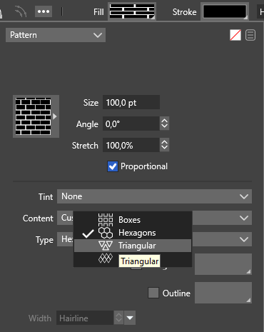

- When I change the content of a fill pattern to another option, like hexagons, it doesn't change. It always shows boxes

@freggern The 2nd problem should be fixed in build 1.1.008
Is it correct that when I change it to hexagons it looks like this: I expected it more that the boxes are now hexagons. And not boxes + hexagons with boxes background. But maybe I expect something other.
@freggern Yes, this is correct — you just changed the tiling type (from Boxes to Hexagonal), not the pattern itself.
When you change the tiling of any pattern, the pattern itself stays the same but is just tiled differently.
In this case, rectangles arranged to look like bricks are centered inside a hexagonal tile.
@b77 Ok, I understand. Thanks for clarify! @vectoradmin The 2nd problem is fixed!
