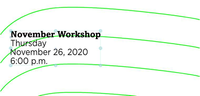

Does anyone know the best option for getting the text or a shape to warp to the lines show in the picture. I've tried the various warp option but none of them allow me to get it just right. I'm trying to make the text look like its a page on a book.

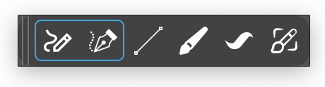

If the green lines are not vector objects, you need to use the Pen or Pencil tools to draw the path on which the text will be placed:

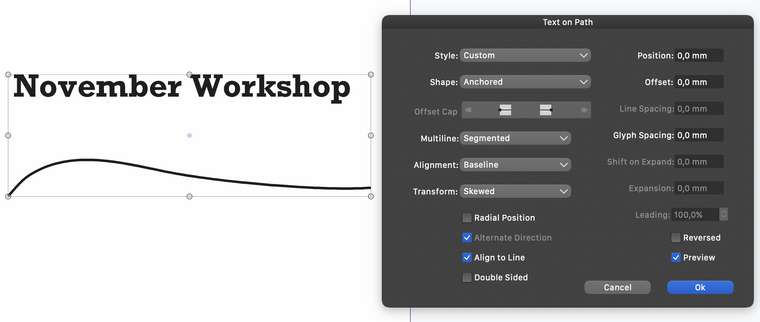

Then write the first line of text (November Workshop), select both the text and the path and choose 'Text on Path' from the app's Text menu.
Make sure you choose 'Skewed' from the 'Transform' menu in the dialog…
…then after clicking OK, duplicate the object and change the text to the second line, then the third and fourth.

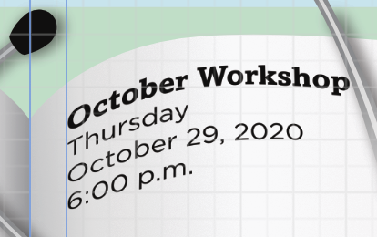

Hi Thanks for the response. However text on a path won't give the look I'm trying to achieve as it orients the rotation of each letter to its position on the path (which is how it should work) and doesn't give that text on open book page look. I've been able to do it in another app but its destructive. Here's an example:

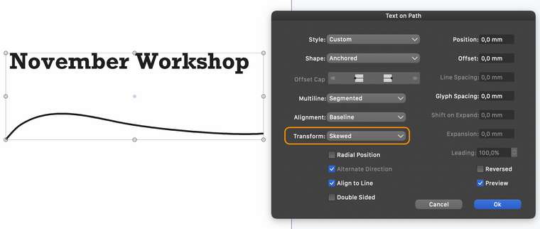

@mbarr Make sure to choose 'Skewed' from the 'Transform' menu in the settings here:
Hi,
Thank you that made a huge difference. There is so much to learn and explore with VectorStyler.
