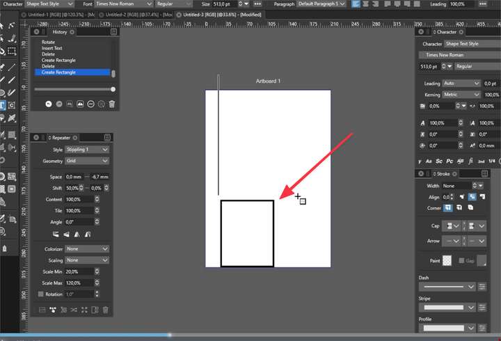

    @vectoradmin Could you check what is going on with that rectangle? It appears often in left bottom corner.

    @vectoradmin Borrowing from @encart's video, what is the square box at the bottom of the screen that pops up when creating text this way? I've noticed it before when I do it as well. I had posted about it on the forum but I might have missed the answer. thanks!
    0_1642092730219_685296fa-43ca-4f1a-b87c-09926a8ff12f-BLD 2022-01-13 at 11.47.31.png

    @Boldline That box could be a missing glyph. I will try to replicate this issue.
  • @Boldline It looks like a missing glyph to me. Changes depends on used font.
