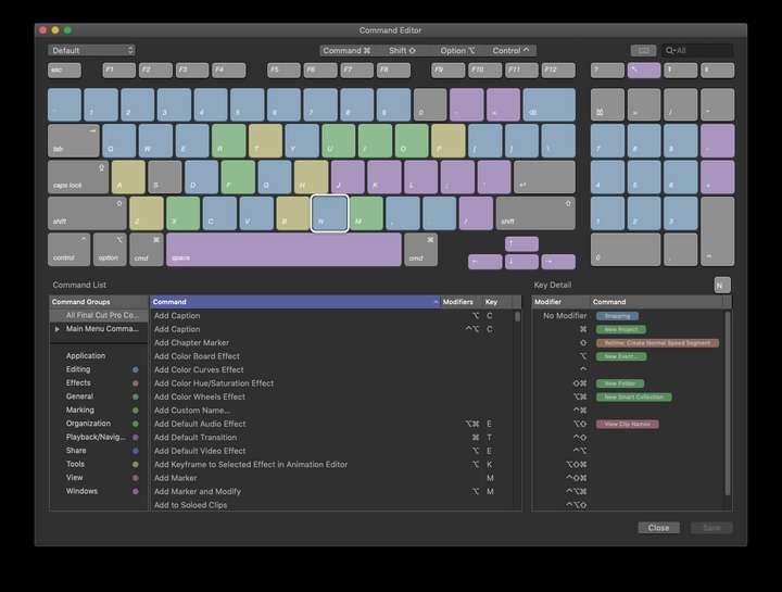

  • I agree that ideally, the interactive search option for keyboard shortcuts should be built into VS.
    Final Cut Pro has a keyboard image that shows a virtual keyboard in the panel. Clicking on a key shows the shortcuts assigned to it with each combination of modifiers. This might be overkill - even just if you selected a keyboard shortcut from the interactive list, the keys used in that modifier would be highlighted in the keyboard

  • I also vote for a Shortcut Finder in VS
    and like @Boldlines "Final Cut Pro virtual keyboard" the most
    i dreamed about a shortcut search function.
    where I get a List whats with Ctrl connected, or key combinations.

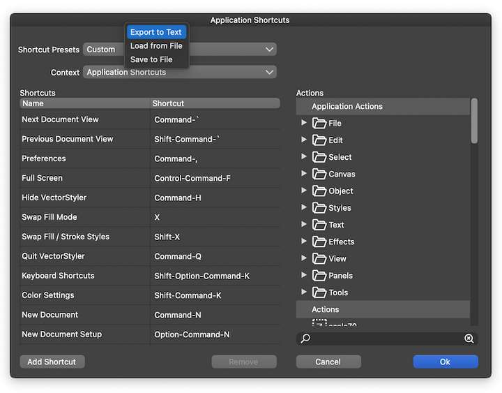

  • @Subpath On the Mac version I can export the shortcuts as a .txt file from Keyboard Shortcuts > Shortcut Presets:
    Can you do the same from Windows and send me the file? Just to make sure we didn't miss any of the shortcuts.

    I created this sorting on basis of the original Standard VS Shortcut
    Text file. Which I can export on Windows exactly the same way as
    you can export it on the Mac.
    But I can also send you my Standard VS Shortcuts as a Text file,
    if you give me an email address.
