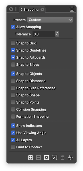

@b77 said in Snap to canvas centre vertically and horisontally:
@Ingolf These are my settings:
No centre of page snapping with those settings here - macOS and Win 10.
Hmm, I think it actually does snap to the centres, but I see no indicator line allthough enabled. Win 10.
Checking on macOS later.
Same observation on macOS - it does snap to the centre(s) but no yellow line displayed.

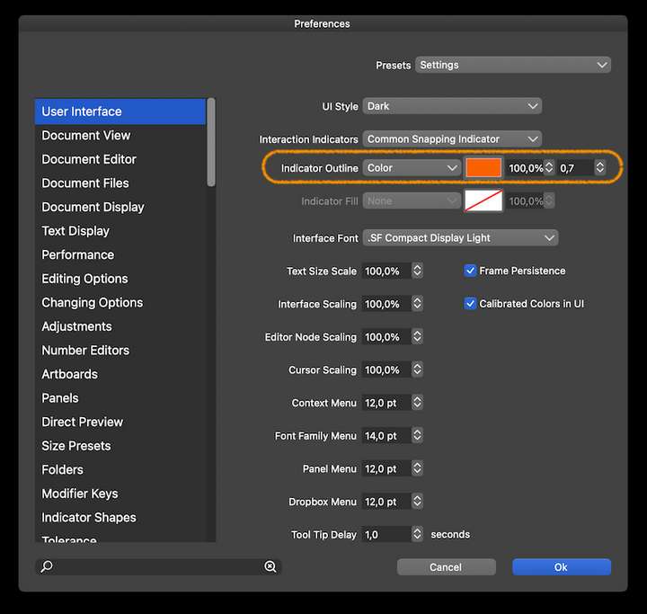

@Ingolf If 'Show Indicators' is enabled and indicators still don't show, check in Preferences > User Interface if the indicator is set to a non-white color and its opacity and outline width are like this:
Hm on both Windows and macOS almost all snapping indicators had an opacity of 0,0% - even when every snapping setting was enabled.
But with your settings I still don't see the indicator lines. What outline color should I look for in preferences, @vectoradmin

It is the same here by default (opacity is at 0.0%), but the snap indicators still work…

It is the same here by default (opacity is at 0.0%), but the snap indicators still work…They also worked here - but no canvas centre lines to see after setting to 100%

@Ingolf The "Common Snapping Indicator" color should be the one.
And the opacity should be 100% by default.
I open a bug on this one, and will try to replicate the issue.
