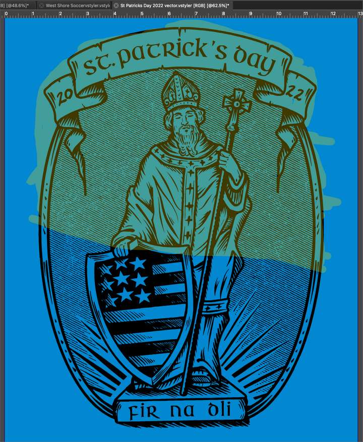

I was prepping this large vector file for screen printing and it reminded me of a discussion with @vectoradmin about the possibility of masking off a selection of a busy complex vector design temporarily to be able to focus on a certain part. The mask could look like a highlighter color so you know it's there, providing a temporary "freeze" or lock on those nodes and effects

i was adding some black fills to this black layout and it took several minutes for VS to merge it together. hypothetically, if I could temporarily exclude an area for VS to look at and merge with, it would probably go faster.

@b77 I may not be fully understanding your question so bear with me. It's not about visibility. it would be more in line with object-based but not entirely that either.
The goal is not to necessarily hide the parts I'm not needing in that moment, but to lock them down to avoid VS draining resources continually referencing them as I edit the design in a small area on the opposite side of things. If there was a mask for what I'm looking for, I'd actually prefer not to hide any of the design and just show the mask as a translucent highlighter like shape over top the section locked down.

Where I run into issues is when the shape I am needing to merge with is already merged with a ton of other stuff - like all the black part of the design I included. I can't 'Hide Object' and 'Show All' because 95% of the design will be hidden including parts I still need.

But if I understand correctly, the complex drawing above is a single object and you can't just select the hatching lines in the background to lock/hide them.
that is correct
