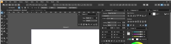

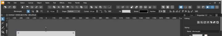

Ok, so far I can't replicate the disappearing panels, but I do get that grey border when VS is not maximized. I have no problems with the taskbar, though.
@Gremriel I got the grey border, and the autohide taskbar is not shown when maximized. Working on a solution.
