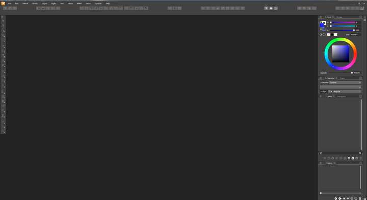

I see the problem on two very different Windows 10 computers. Task bar (configured to auto hide) pops up in all programs, also programs running in full screen mode, when mouse button is lovered to the bottom of the screen.
VS however runs in exclusive full screen, moving the mouse button to the bottom of the screen doesn't result in the taskbar popping up. Switching to other programs I see the task bar auto showing again, returning to VS = taskbar doesn't pop up.
With horrific colors because of no support for my wide gamut monitor profile (also a VS exclusive) I only run VS on macOS though
Ok, so far I can't replicate the disappearing panels, but I do get that grey border when VS is not maximized. I have no problems with the taskbar, though.
@Gremriel I got the grey border, and the autohide taskbar is not shown when maximized. Working on a solution.

I am also having this problem, but, interestingly, it depends on which monitor the program is fullscreen. On my computer's primary #1 monitor, I do not have this problem at all, though for some reason the very top of the monitor is not filled by the program (2160x1440 resolution & 27" if that matters).
On monitors #2 & #3, the taskbar is hidden when fullscreen. Windows 10
@Mongeuse I will try to replicate this with a dual monitor setup.
Very small addition to this problem, but it seems the very top of monitor #1 not being filled by the program only occurs when monitor #3, a display tablet positioned below monitor #1, is connected. When it is disconnected, restarting the program and using fullscreen then properly fills the very top.
This doesn't help with the main hidden taskbar when fullscreen on monitors #2 or #3 problem, of course, but it at least clarifies the cause of this other problem.
@William-Kansepa This problem should be fixed in 1.1.048
