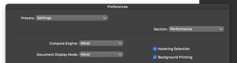

If you go to Preferences -> Performance section, you can see the display and compute engine selection.
What do you have here?Both should be Metal for best performance.

@vectoradmin my Mac mini has
Intel UHD Graphics 630 1536 MBand I am using Metal for both.Though my prefs panel looks different to yours.

Yes the preferences view has been updated.

You could try in the Preferences -> Performance, if Metal is visible, and how it performs.
In Sierra, metal compute was not yet complete, so probably there should be OpenCL.
For display mode, try if Metal works, if not OpenGL.For your config, probably Metal for Display Mode and OpenCL for compute.
Software is a last resort. For compute it can be acceptable if you have cores, but for display it can be slow.
