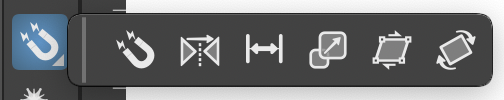

    0_1647710423716_eb5bb9bf-8e5d-4766-8b99-fffe4d447612-BLD 2022-03-19 at 13.19.56.png

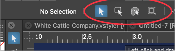

    @Boldline I added this to the backlog, but this would not be suitable next to those selection modes.
    Those are "what we want to select" mode options.
    And this would be a tool for "what we want to do".
    So the "Move tool" would work better among these (next to scale, skew, rotate tools):

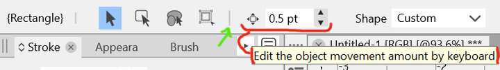

    I wanted to add to this thread to call out what I thought was a brilliant function of VectorStyler in the Context Panel:
    This (in red) has greatly helped me with the issue @Boldline is describing, as I can fine-tune my arrow keys to get around this.
    That said, I also agree that an object "Move Only" mode is a good idea and not something many vector graphics apps have. 👍 nice idea!
    As for placement of the "Move Only" Tool, may I suggest an additional location?
    Considering how it is so close in function to the "Edit the object movement amount by keyboard" (image above) perhaps it can also nestle between this and "what we want to select" mode options? See green arrow in image above. This would put it close to where @Boldline originally thought.
    But yes, it still should also be placed on the tool bar where @vectoradmin suggested, in the "what we want to do" area...

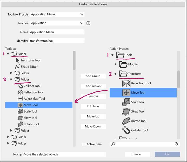

  • For those not using the Default Toolbox, you may add the new Move Tool here, under View > Customize > Customize Toolboxes:
