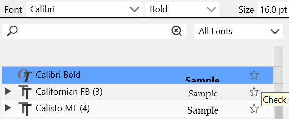

    I am running VS 1.1.036 on Win11
    The ubiquitous Windows font family, Calibri, is installed on my system with 6 fonts, yet only one font, bold, shows up in the VS interface.
    The expected behaviour is to see all 6 fonts in the interface with a drop-down arrow beside the font family name. A quick check in Affinity Designer reveals all 6 fonts are present.
    I only checked Calibri for this issue. It could be on other font families, but I have not verified any others.

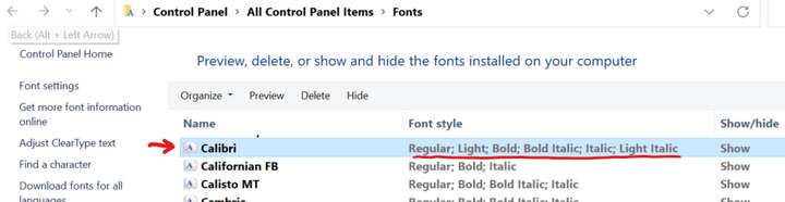

    Windows 11 Installed fonts:
    VectorStyler:

    What is the location (folder) where the Windows 11 fonts are installed?
  • @vectoradmin Selecting "Installed Fonts" fixed it so I can see all six installed fonts in the font family. Why does it not display them when "All Fonts" is selected?
    The fonts are installed/reside in C:/Windows/Fonts. The folder is hidden.

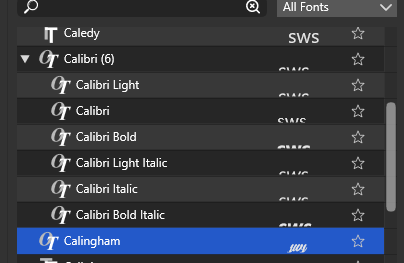

    @Victor-Vector Looks like a bug, it can also be replicated here.
  • @vectoradmin Thank you for fixing in 1.1. 037!
