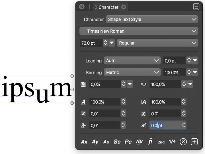

  • attempting to adjust the leading of one character to sit below baseline. no response to input in character panel. character will not move up or down?

    I think this could be done via
    Menu -> Panel -> Text -> Character
    @electroplated To offset a character baseline, use the baseline offset option in the Character panel lowest row right numeric field.

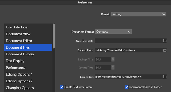

  • @electroplated
    You can define your own default Placeholder Lorem Text in the Preferences.
    Or switch off the default Placeholder Text Content by uncheck "Create Text with Lorem"
  • very helpful, thanks. that's what I needed to know
