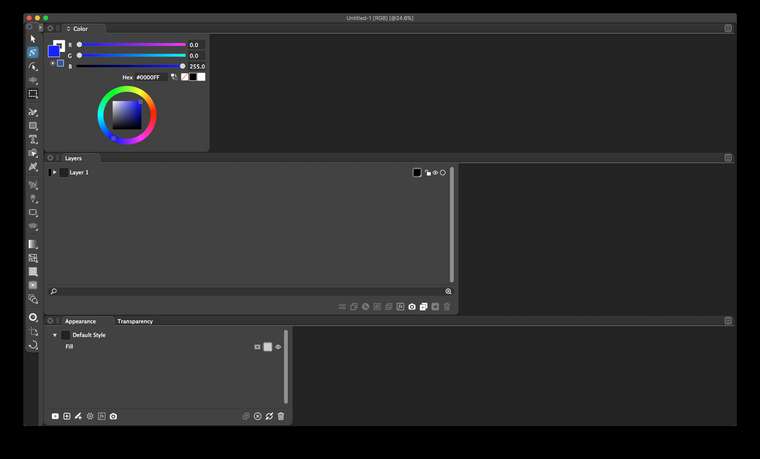

I've noticed over the last couple beta versions, when I go to open VS for the first time. All the panels and boxes are shifted to the left side because there is no open document. But even when I go and create one, I still have to manually rearrange the layout, or go in and reset the workspace under Vectorstyler>Workspaces
Is this a bug or did I need to do something to fix this on my end? thanks!

@Boldline Seems that problem exists even after reset (could be replicated).
Will include a fix into the next build.
@Boldline There is a new build with improvements on panel persistence.
@vectoradmin just installed it and works perfectly now
