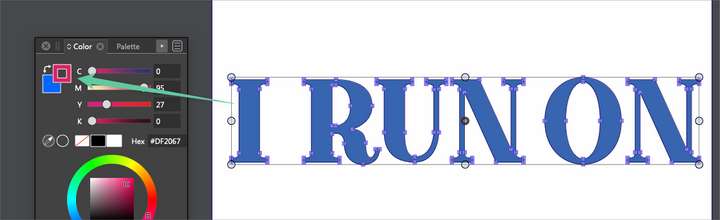

Cannot get rid of stroke and it changes color in odd ways in the color panel

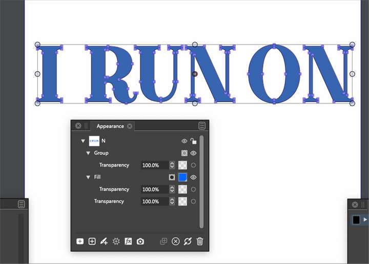

I am working with some expanded text and it seems to have a stroke attached to it that cannot be removed... I don't know if it's related to it being a compound path
@Boldline Maybe it has two strokes? Check the Appearance panel, or post the file here.
@b77 file is posted - the link is right above the image. is there a better spot I should put the link?
I did check the appearance panel and I did not see any strokes listed there
@Boldline At least here, this seems to be a clipping group, containing some red outlines also.
@Boldline Sorry, too much blue from the video link above and I didn't see it.
Strange. Once you change the stroke width to something else, a stroke attribute is assigned and changing its color works as it should.
