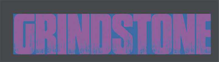

    From this general selection, I cannot use the keyboard shortcut to edit the tracking of the letters in this word.

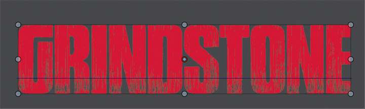

    ONly when I select the entire word highlighted can the tracking be adjusted

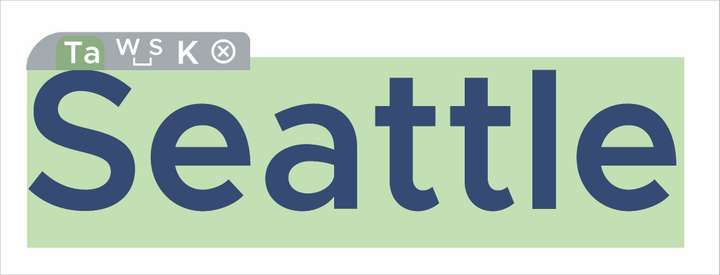

    Someone a while back posted the idea of adding commands directly to the selection box. What about adding commands directly to a live text box as well? user would highlight the word with the text tool (maybe we expand the use and name of the text on a path edit tool?) Sort of the way the character tool currently can access individual letters and words and adjust things. the user would select the word or highlight the letters involved and click on the tracking symbol right above the text box and the highlight would change color to demonstrate it's now in tracking mode and then regular left and right keyboard keys would work to modify. Here's a mockup of the main idea:

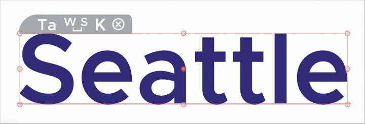

    adding to this new future idea - perhaps if the highlight changed color for this part based on what tool is being used?
